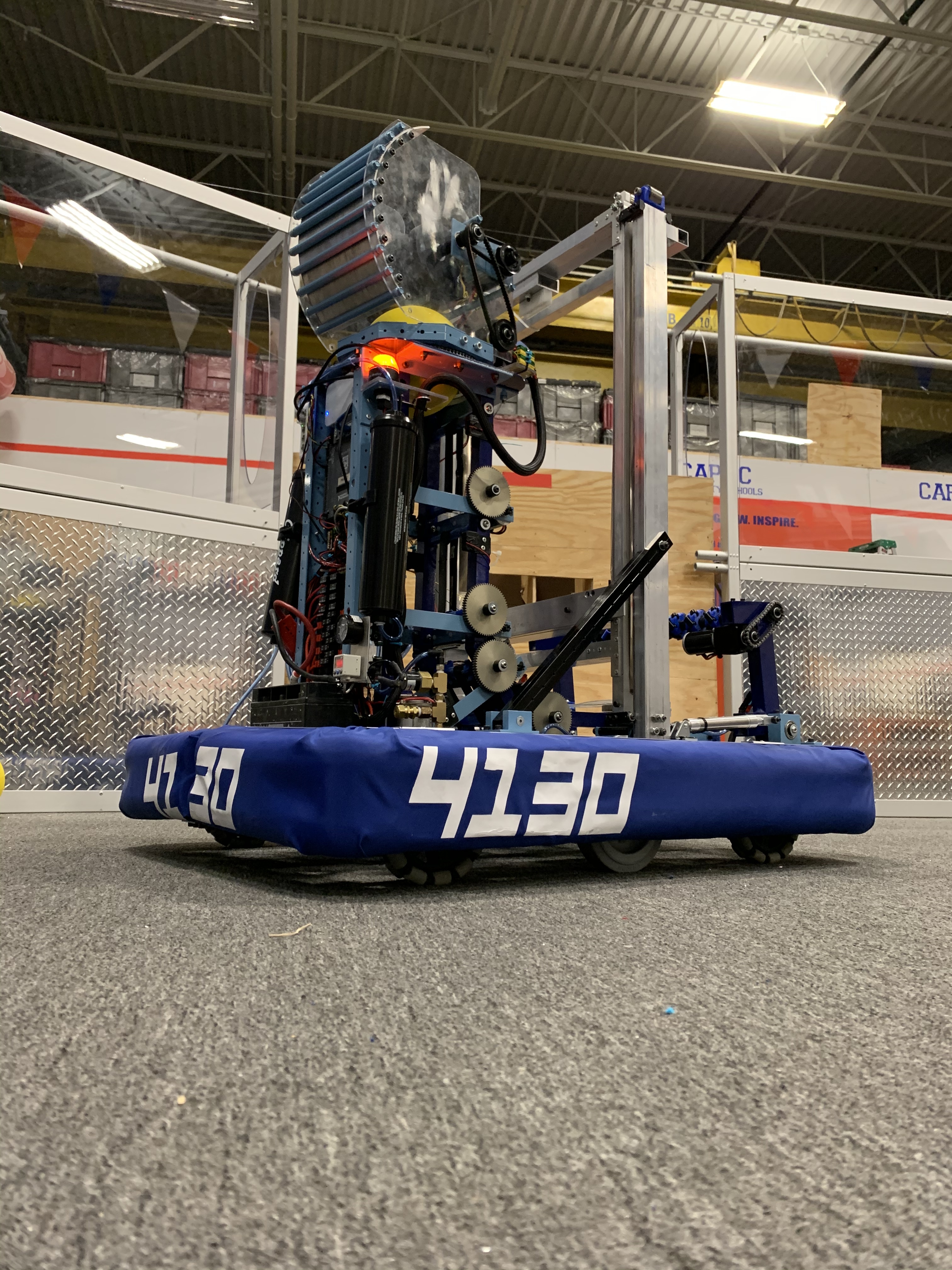

Now that we have competed an entire today, Team 4130 The Blue Devils presents our 2020 robot Renegade! We will be competing at Southfield, Waterloo, and Marysville. Good luck teams!
Nice bot! What wheels are you guys using for your shooter?
WCP Solid Roller Wheels. We’re using the 4”x1” 60A durometer. We have two of them. One on the outside, and then a 2” wide by 2” thick flywheel and then another WCP wheel on the other side. This is done to center the ball when shooting.
