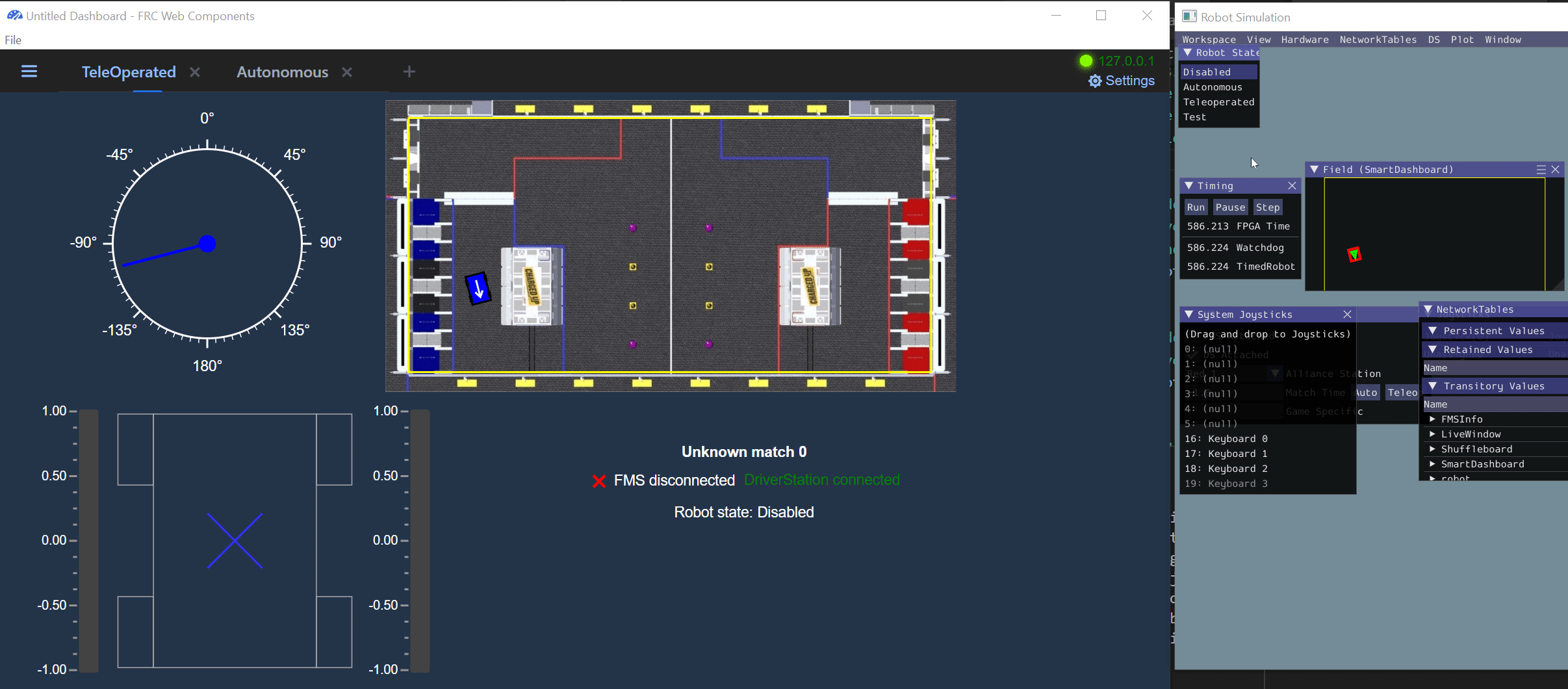

  • Can it work when simulating robot code?

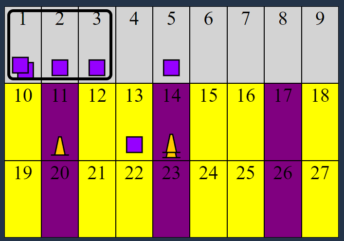

  • One of the major things our drivers having been asking for is a way to display the grid and track both pieces scored and a way to indicate where we are scoring next. I think something similar to either the scoring location breakdown on thebluealliance (bonus points for maybe being able to “borrow” their source) or similar to this image from the manual:
Unfortunately I currently know nothing about LitElement and wanted to see how much benefit others in the community would see from this custom component.

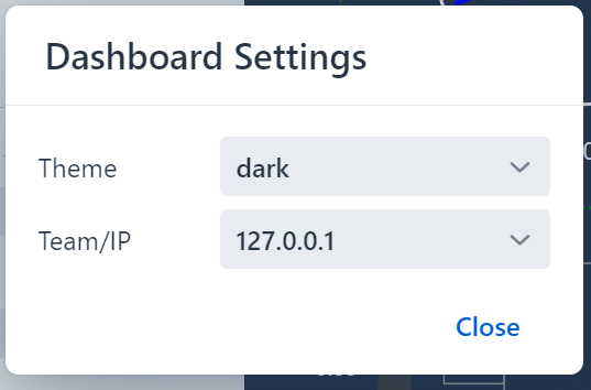

The dashboard does indeed work while simulating robot code. All you’ll need is to connect to 127.0.0.1 or localhost and run the simulator:
Code_ZtB1b88w3y

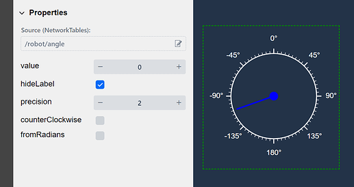

Styling is currently not well supported in the dashboard, but it’s something that’s been on my todo list. What I’d like is to have a view to set style properties similar to the view you see when setting element attributes/properties:

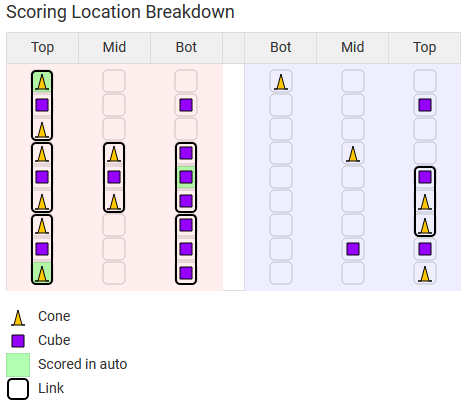

Have you by chance looked in creating a scoring location breakdown component? My team was thinking of making something like it for our next event.
9 months later, we would still, highly benefit from a walk thru example type for this idea. Teams playing games with multiple scoring locations could really benefit from an example if any from the community has put one together yet.
Just added a scoring grid component based off a svelte implementation created by @Amicus1:
You can try out the component here: @storybook/cli - Storybook
Like the other components this was implemented using lit. You can find the source code here.
Will share examples of the component used in a custom dashboard when I have a bit more time. Dashboard app will need to be updated to.
