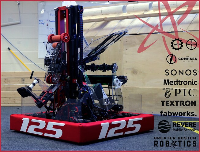

The NUTRONs are proud to present our robot for our 28th competition season, PHASE SHIFT.

The flipping coral mech is definitely the “wish we had thought of that” mechanism of the year. Packaging and integration on this robot is incredible.

I’m missing what the point of the flipping Coral mechanism is. Just to have fewer positions to align with on the Reef?
It also means they can center on each reef face and smoothly pick up algae as well, regardless of which side they’re scoring on.

Was so confused about that coral mech from the image but that’s so cool!

Beautiful… Love that coral mech.

Love the flipping intake ! Is that a separate intake for L1 ? or is the camera deceiving me
Separate intake to clean up coral off the floor and drop it onto the level 1 reef shelf :slight_smile:
Love the angled wrist!
