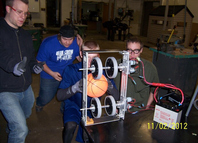

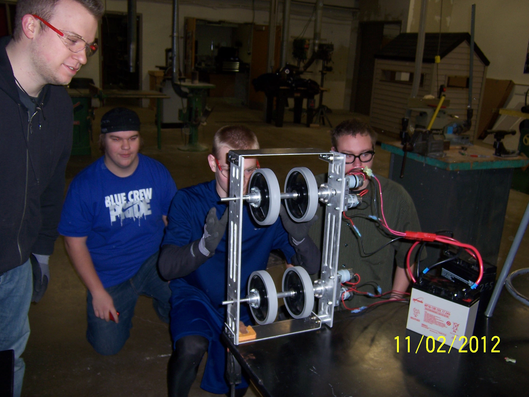

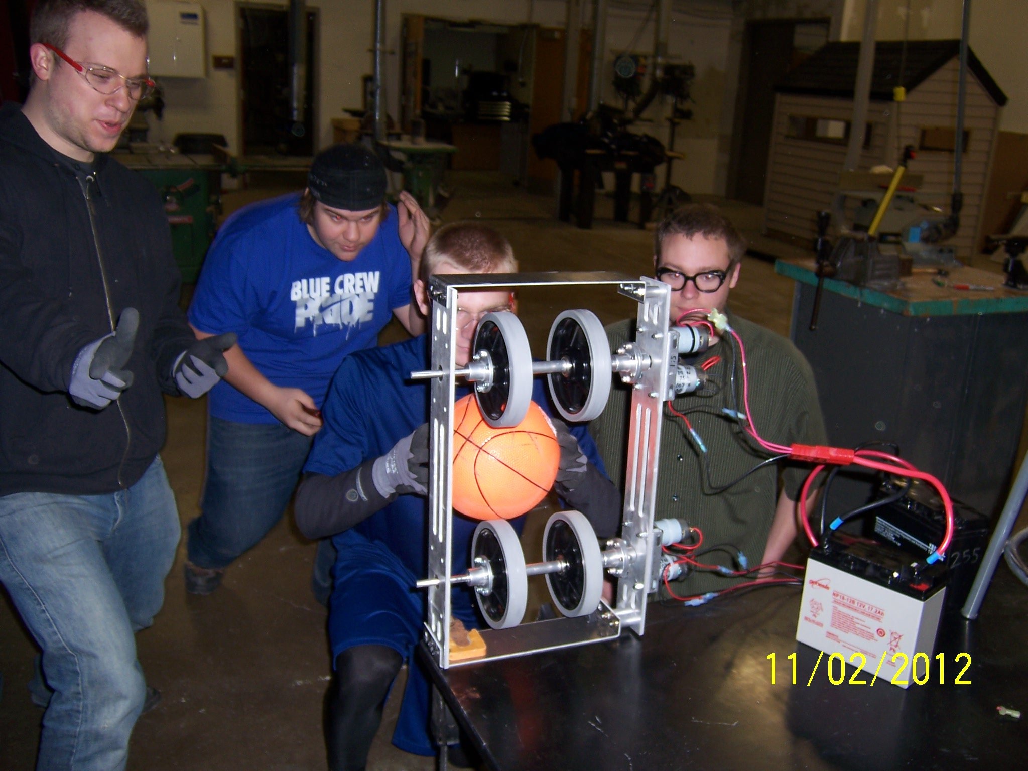

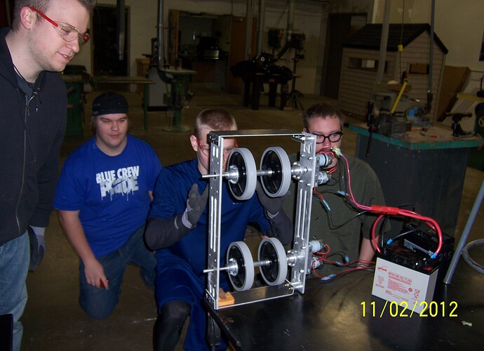

Here’s a before/after snapshot of our 2012 shooter in action.
Now you see it!, now you don’t. Ball shot horizonatally for 16 feet. We’re
running at full speed (motors run cool).
We’re using 2 CIMSim’s with 4 motors, 2 FP and 2 Andy Mark direct mounted
to 3/8 shaft.
Wheels are FIRST - 6 inch smoothed down to become flat.
Next step is mounting the shooter.
See you at Waterford, MI and then Troy, MI
This design is cool. I don’t want to be a party pooper, but I have a few questions.
First, what do you mean by 2 CIMs and 4 motors? I only see 4 fisher-price type motors in the pictures, no CIMs.
Second, why in the name of Kamen would you smooth your wheels? the fact that you’re only getting 16 feet from a 4 motor shooter means you’re losing a lot of energy between the energy and the ball. The usual idea is to make the wheels high-traction so that less energy is lost to the wheels sliding along the surface of the ball.
It looks pretty darn awesome though!
Oh - thanks for spotting my goof. Thanks for commenting
I mean to say (CIMSim), the Andy Mark, Product but only managed to get the CIM written down. We left all 4 CIM’s in our drivetrain.
Good question on the wheels. I had read about this year’s knobbed FRC wheels tearing up balls so I took the wheels we have which were inverse crowned and had them smoothed flat thinking that the judges couldn’t complain about that at the competition. That leaves spacing of the wheels and compression of the ball being the major factor in tearing apart balls. Reading posts on CD I realized that 1 to 2 inches seems to be popular so I chose 2.5 inches at the major diameter of the ball. so the compression is 3 + 5.5 + 3 at the very middle, but the wheels contact further out where the dimension is more like 3+ 6 + 3 ( 1 inch on both sides compression).

I talked to someone today and they said running the top rollers and bottom rollers at 10% speed difference will provide sufficient ball spin. I am eager to test that concept when I get to the high school again.
The 16 feet horizontal shooting was when the ball shooter was mounted onto the desktop as shown. When we tipped the device to 45 degrees we obviously shoot further but hit the wall where I was unable to measure true distance.
I think shooting at far distances may be difficult due to the ball being very bouncy. We are planning on dialing down the speed to “toss” the ball into the net. Experimentation is of course required.
I see. Also, what do you mean by the balls are “bouncy?” I’m not sure I understand what you’re saying. Are you talking about the deflection inwards made by the wheels? In addition, will you need to change the angle of the shooter to give you different angles/range?

Wheels with “high traction” tread patterns tend to turn the surface of the basketballs into orange snow.
