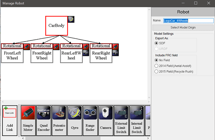

There is also the Synthesis simulation code from Autodesk (but it is open source)
https://synthesis.autodesk.com/
So far, I have driven around the precanned robots, but have not had much luck. But also have not put much time into it.
612 has been doing a lot of work trying to get Synthesis to work. From my understanding, we were able to get our robot CAD into the program and simulate the code, but it was rather buggy and didn’t work great. @ProPra you know more about how Synthesis went for us.

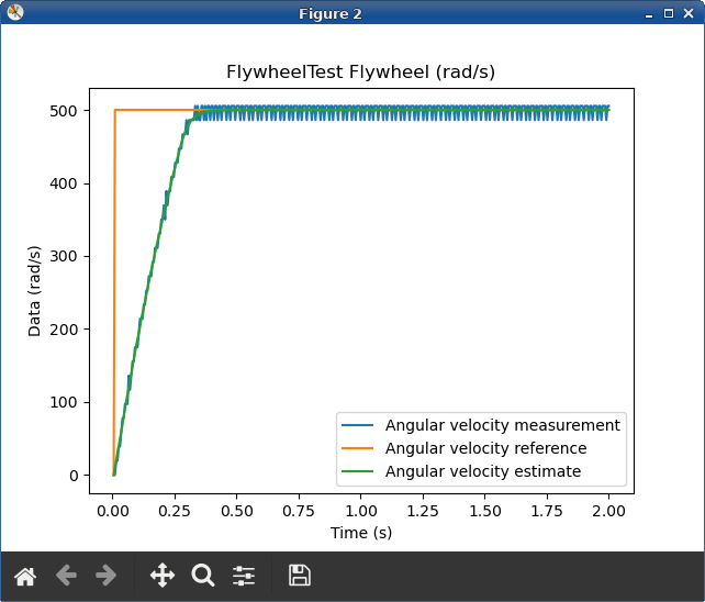

More on EncoderSim internals
When you call SetPosition() or SetRate(), it’ll convert by the distance per pulse and set the internal count such that GetPosition() will return the value you passed to the setter. The simulation encoder setter rounds the internal edge count to the nearest integer, which gives you finite resolution, as you’d expect. It’s kinda nice the HAL sim inherently models that. Here’s an example of that quantization error causing noise in a simulated flywheel’s angular velocity calculation (change in angle divided by change in time).
