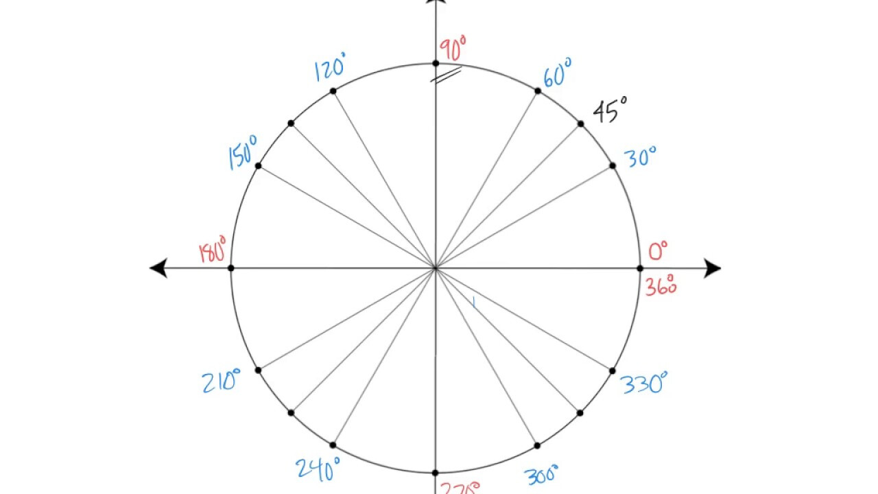

the brighter red circle in the middle is the center of the robot, while the darker point to the right, along the perimeter, is 0 degrees (as in unit circle).

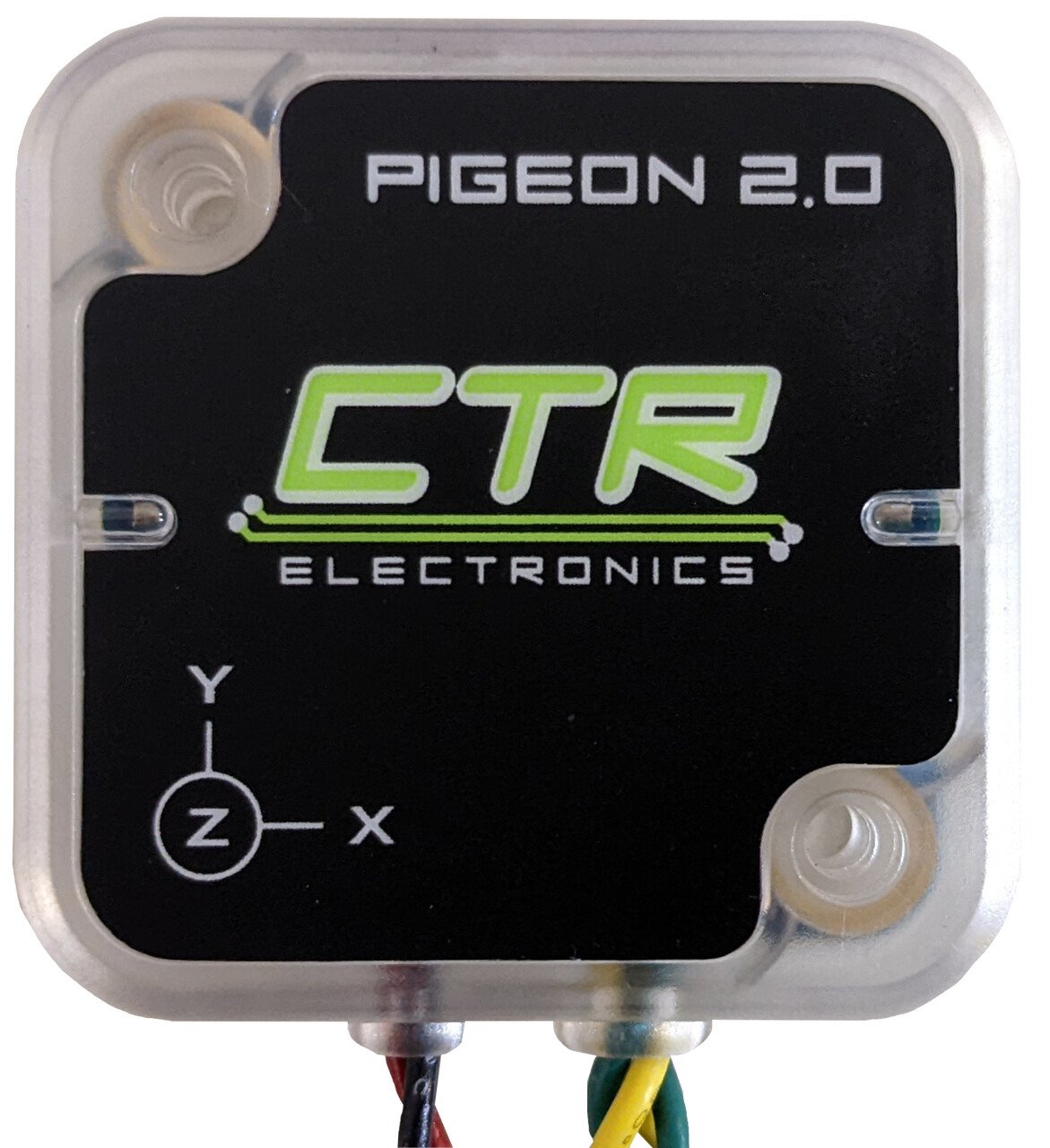

this corresponds to your robot gyro, which in the case of a ctre pigeon, follows the diagram printed on the case:
0 degrees will be on positive x, 90 degrees on positive y, 180 degrees on negative x, 270 or -90 degrees will be negative y
hope this helps!
