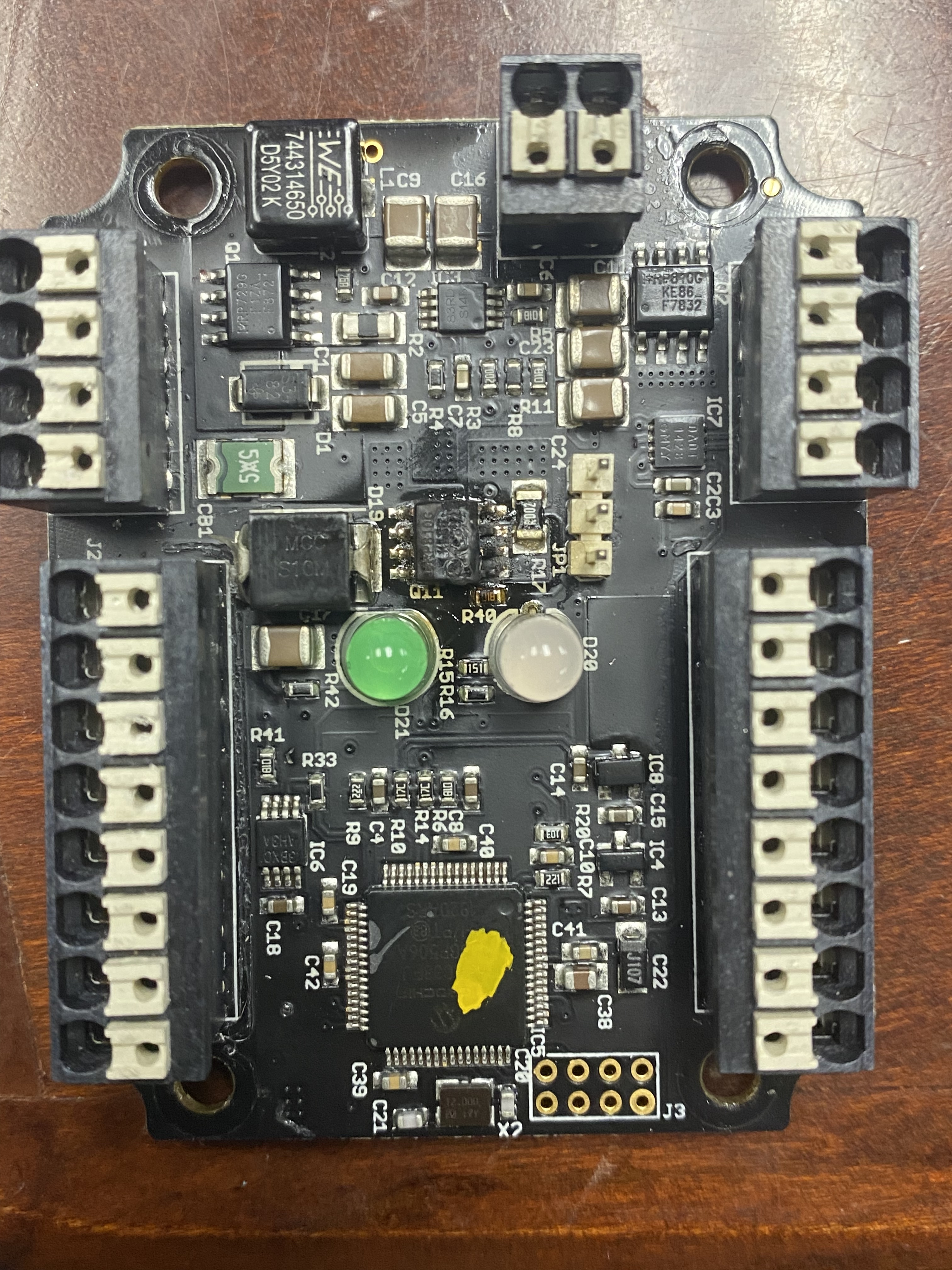

Hi there, desperately needing help. We are on our 3rd fried PCM. Right now our cirtuit is the most basic: compressor, two tanks, one two state solenoid valve and one actuator. A chip in the center of the PCM keeps getting fried.
This happens when we are activating the solenoids. compressor starts charging properly and then this happens.
Any idea what might be going on? Why would this fry this way rather than protecting itself somehow?

One of the things is that we were using an older AM-3227 compressor that can pull up to 16 amps… switched now to a newer Viair compressor, max 12A. Hopefully will be better.

Just did that. The component is quite fried to see, but seems to be an IR MOSFET, so the guess is that this is the driver for the compressor.
We are currently working with CTRE to diagnose the faul. It seems to be related to the control of the compressor. Will update if we can figure out the root cause and the resolution
