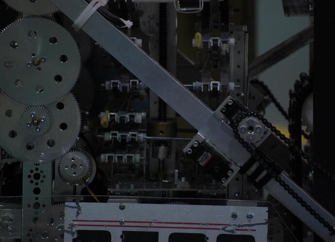

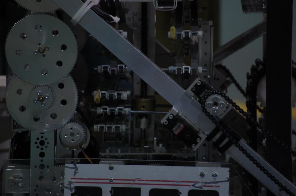

Last weekend I saw this scissor lift at a championship. It was really impressive and could lift two crates 4.5 feet. They drove the lift with a threaded rod and a bronze thing. However, I could not find the bronze thing on the Tetrix website. Where could I get something similar to that?

It is an acme thread and acme nut.
I don’t believe their use satisfies R5c18 and wouldn’t allow them to compete, but I am not an inspector for FTC.
Check out ruling #33 in the Forum. http://ftcforum.usfirst.org/showthread.php?355-The-Robot-Parts-and-Materials&p=2130&viewfull=1#post2130
That team won the championship and qualified for St. Louis using that design. What is the community norm for a situation like this?
“Any thread, any fastener”.

The FTC forum answered that lead screws specifically are not allowed. This appears to be a lead screw from my experience. while they have won an event, I don’t think it can be taken away, but inspectors at Champs may find a problem with it. If I was the team, I would think about an alternative mechanism. 3/8" threaded rod is allowed.
I found the actual post Al Skierkiewicz was mentioning. So are fasteners that are not similar to tetrix fasteners legal?

A: No, a lead screw is not All-thread. Nor is it a fastener.
UPDATE 10/25/11 - Lead Screws are now allowed. See Post 33 in Parts and Materials
Al, http://ftcforum.usfirst.org/showthread.php?355-The-Robot-Parts-and-Materials&p=2130&viewfull=1#post2130
Monty, any nut/fastener is allowed. Screws are limited to machine-type (not sheetmetal or wood-type, and I think self-tapping is also excluded).
Check out the entire Materials thread in the link above…
Thank you for the update.
Oh hey that’s our robot! Yes, we use 3/8" double-threaded (acme) rod. We got it from McMaster-Carr. I’m not sure what nut that is exactly, but we did have to tap it in order to attach it to our lift.
