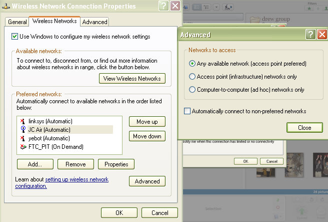

We are unable to connect with our samantha on our bot. We have opened up the config file. created our ssid, downloaded to samantha and the white led only flashes. We open up our wireless network icon. sometimes we get the pc trying to connect to the samantha, but it looses the connection when the samantha does not talk back to it.

I had to disable any wireless connections to other routers before I could establish a computer to computer connection. I set my advanced wireless settings to “only connect to ad-hoc networks”.

right click your wireless. “view available networks”. “change advanced settings”
Then see the picture below. I had to select "connect to ad-hoc only. this disabled connecting to my schools network - which it wanted to do automatically.
connecting via adhoc was the manual I used.
