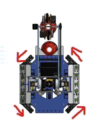

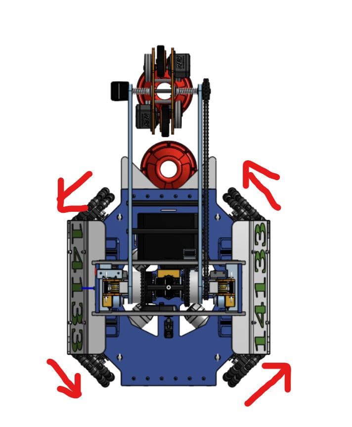

This is a top-down view of our robot. Positive motor direction for each motor is shown with the arrows in red.
We have a table depicting how we intend the wheels should move vs. how they are actually moving in sheets. The below table shows where we commanded the controller (0 deg being forward) and what the corresponding directions of the wheels are:

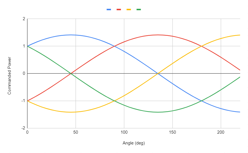

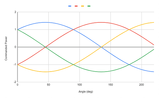

The maximum speed direction for an x-drive is when traveling at a 45 degree angle, so simply adding joystick inputs will work for basic motion, but if you want to move based on a heading you can use some trig, hense the atan2 to find the joystick heading and sine functions to get the component of the heading relevant to each wheel.
In other words, the speeds of the wheels should look like this for all 360 degrees of possible motion before normalization:
The adding algorithm (what you described) looks like this instead, the same graph scaled slightly differently:
Now, at 0 and 90 degrees you can see none of the wheels are moving at full speed, which is where the normalization comes into play, as you discussed. After normalization the graph looks like this:
Your method (also our previous method) generates the same final output graph but is not based on heading. It’s a minor difference, but it’s something we are trying this year.
