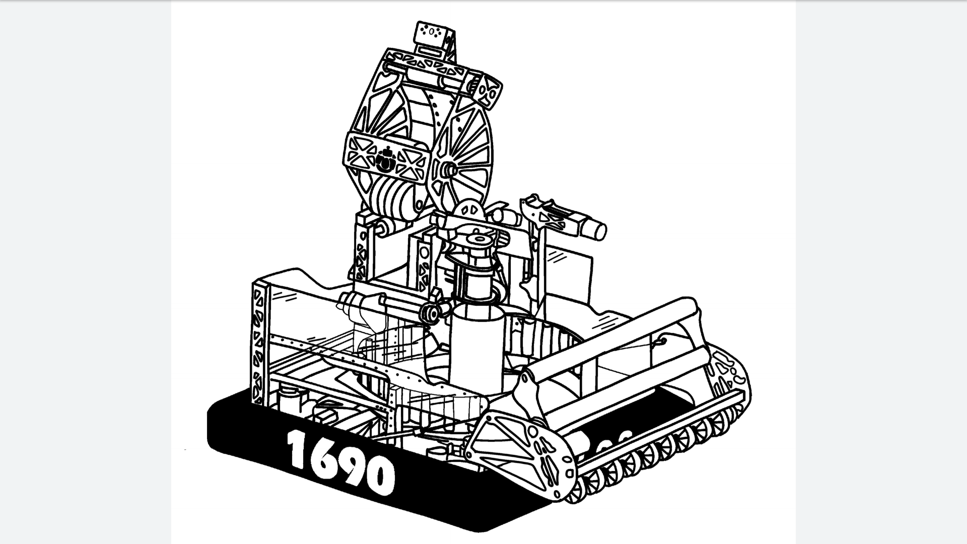

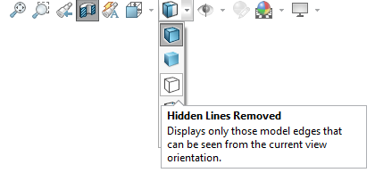

I’ve been looking at some team’s shirts and some have a full robot sketch on it that looks super cool. Does anyone know how to do it? (im assuming its from a cad program), or if you have to hand draw it in something like Illustrator or Photoshop.
Example From 1690:

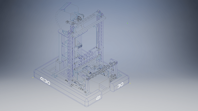

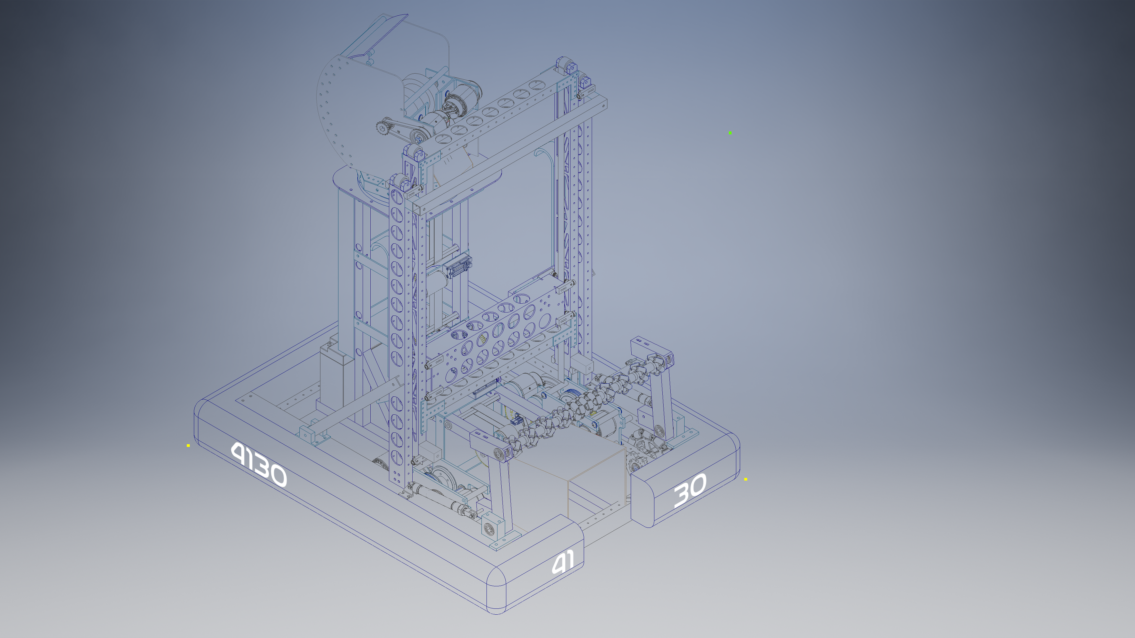

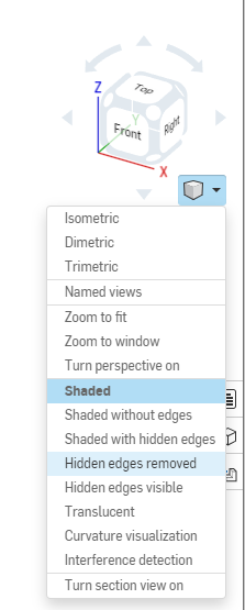

You can get it from most CAD programs - you change the view settings from “shaded with edges” to “hidden lines removed” (exact terms may vary from program to program). Here’s where it is in Onshape and SolidWorks:
sw
Once you get a screenshot of that, you may need to play around with it in Illustrator or Photoshop to make it look good on the shirt. We were going to put our robot on our shirt this year, but it had too many fine lines (such as on the omni wheels) that would have blended together and looked like scribbles, and then we ran out of time.

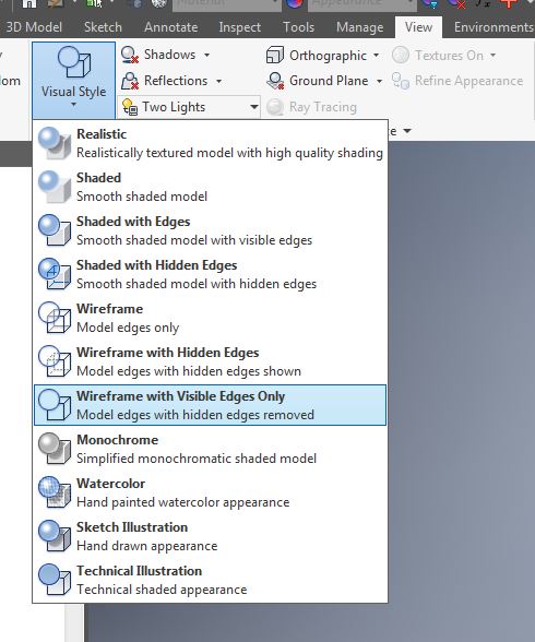

Pretty much the same thing in inventor
