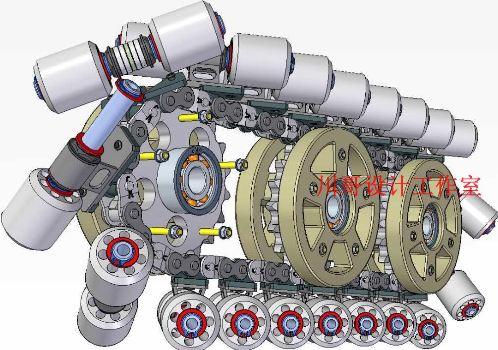

Not my design but proposed in response to the idea
