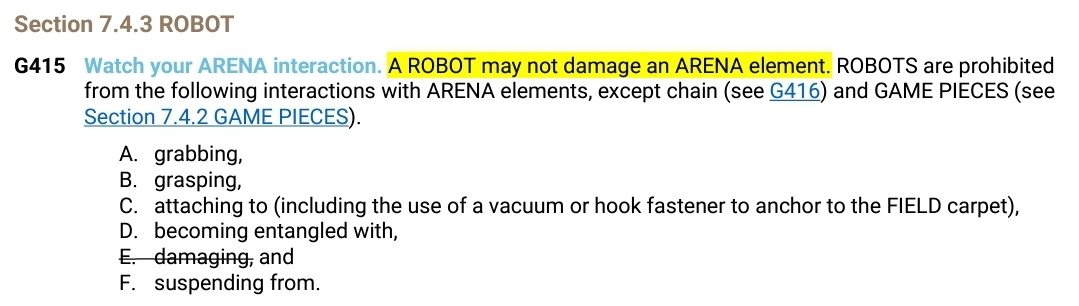

Would using suction cups on the face of the stage to help drive the robot up while scoring in the trap be allowed? I am looking at G415. Theoretically, if we used suction cups on wheels, would this be traction or would this count as grabbing or grasping?

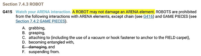

Via team update 6 the damage rule was specified again, but I think this falls under suspension from something other than the chain as well as attaching. This isnt a vacuum system per say, but that is an including X y and Z, not limited to. The suction cups wouldn’t be able to release pressure easily and would pulling on the panels, possibly pulling them off with the weight of a robot suspended on it.
I feel this falls into illegal territory, id ask in the QA if it hasn’t been already asked.
Just go with line C, “attaching to”. Good for one discussion with the Head Ref and one Tech Foul, and possibly one re-inspection.
I’d go with the more scientific definition of vacuum. Whether you’re using a passive suction cup or a powered air pump system, using a “vacuum” to attach to the arena is not allowed.
