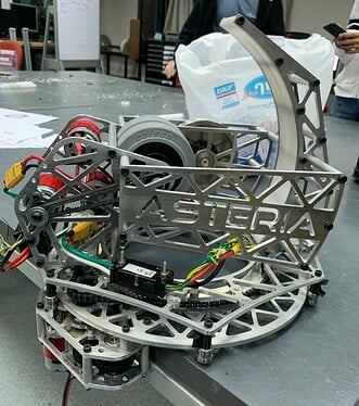

“Flipped” turret –
The shooter sits on a turret, with the bearing stacks riding on the outside of a circular plate solidly attached to the robot base. The turret is driven by a custom-machined 125t sprocket.

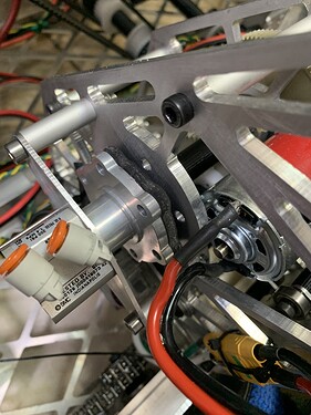

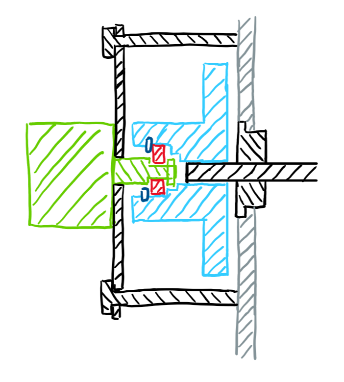

Pneumatic climber break –
Inspired by 971 and the WCP brake, we developed our own pneumatic friction brake made from a single 1/2" hex hub. The pancake piston presses a rubber brake pad into the climber gearbox side plate, which locks the climber gearbox shaft in place. Each brake was calculated to hold 191 lbs at 60 psi.
