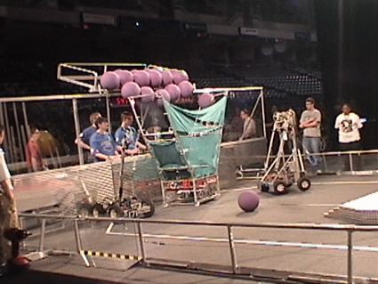

Team 341
Miss Daisy
Philadelphia Chairmans Award
4x4 Tank Drive at 8.5 FPS with Drill/CIM and worm gear (can’t be backdriven)
5 pt ball handler- capable of sucking up 9 5 pt balls and delivering
12 foot mobile retractable telescoping arm- hang from floor
Locking hook- took 2 people with ladders 5 minutes to remove at Philadelphia
Can uncap goals but cannot cap
Dual window motor winch with tape measure :stuck_out_tongue: (come see why)
Able to grab and tow goals
Autonomous: grab goal and bring back, knock over 10 pt ball
