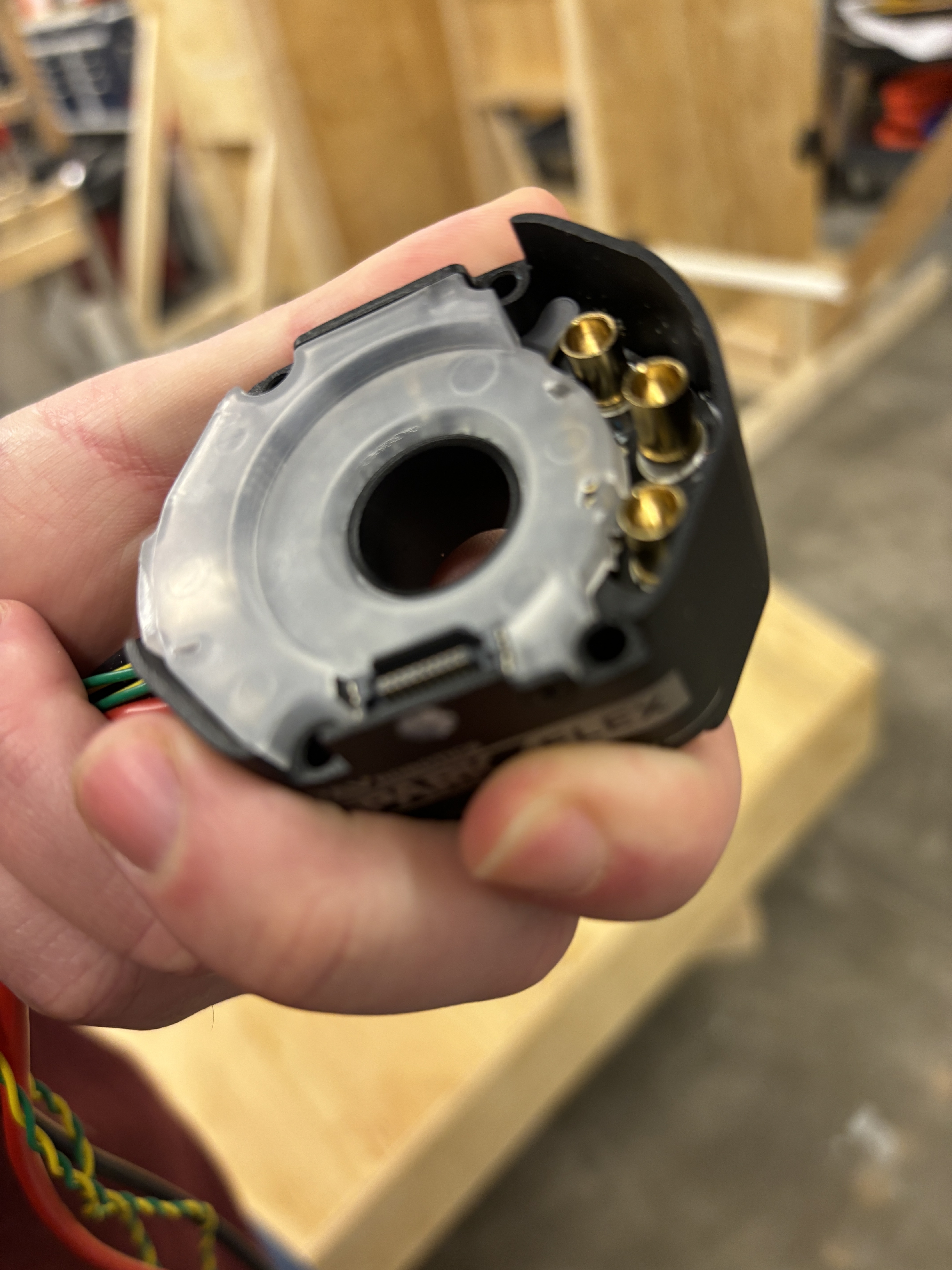

In our robot design, we have a Neo Vortex w/Spark Flex on our intake. Recently, after mounting the Spark Flex, we received a gate driver fault. After removing the Motor Controller, and testing it on our test panel, the error still showed. We then replaced it with a known tested working Spark Flex, and once mounted onto the robot, it also gave a Gate Driver Fault. Our first instinct was to check if the bolts were too long, but we checked and they are only going .25 in into the spark flex (albeit an exact .25in). All the troubleshooting for this error says is to contact REV, which we did. Is there anything that could be causing this error multiple times? We couldn’t find too much about it. Thanks!

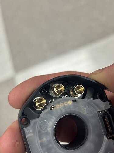

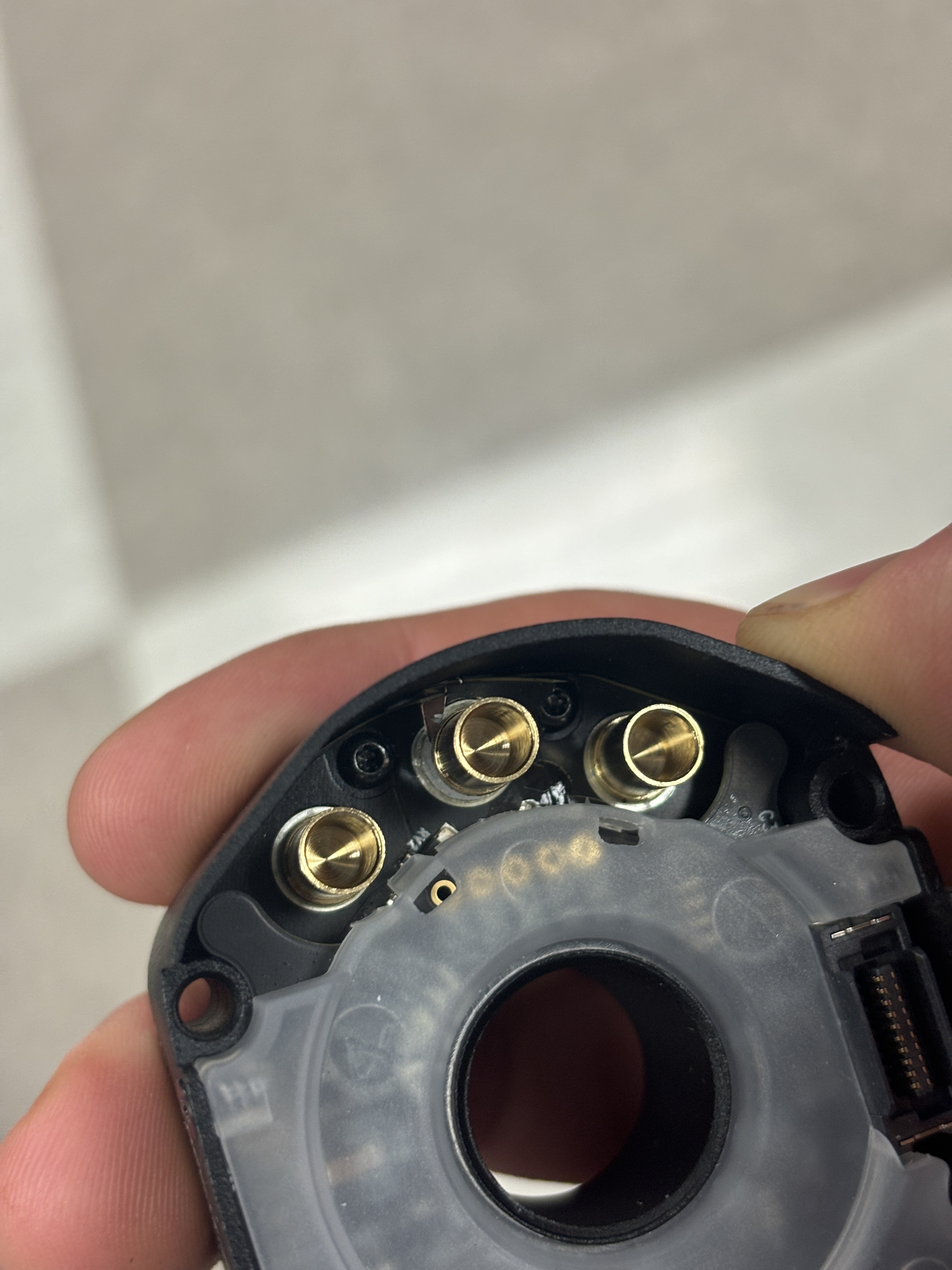

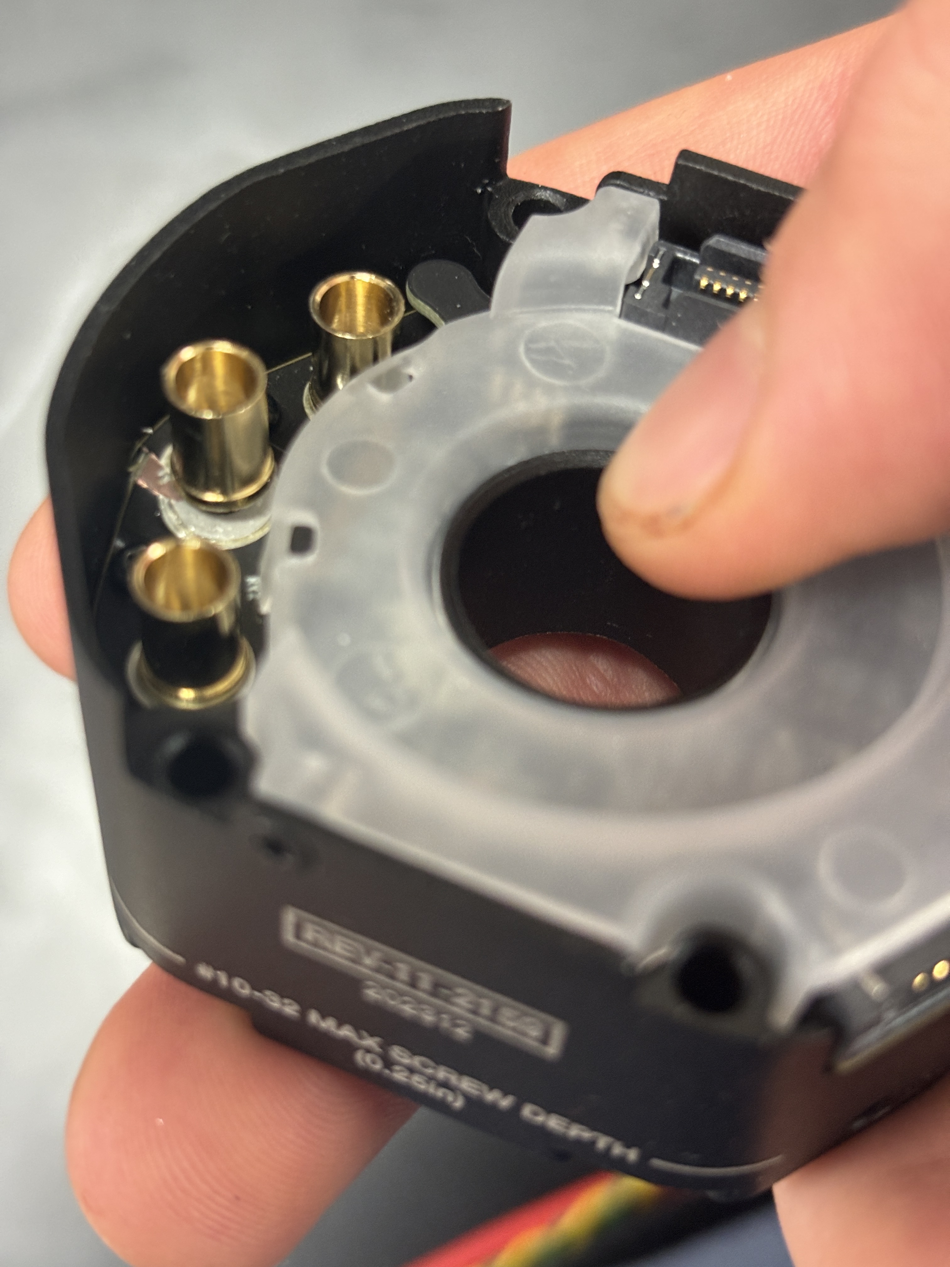

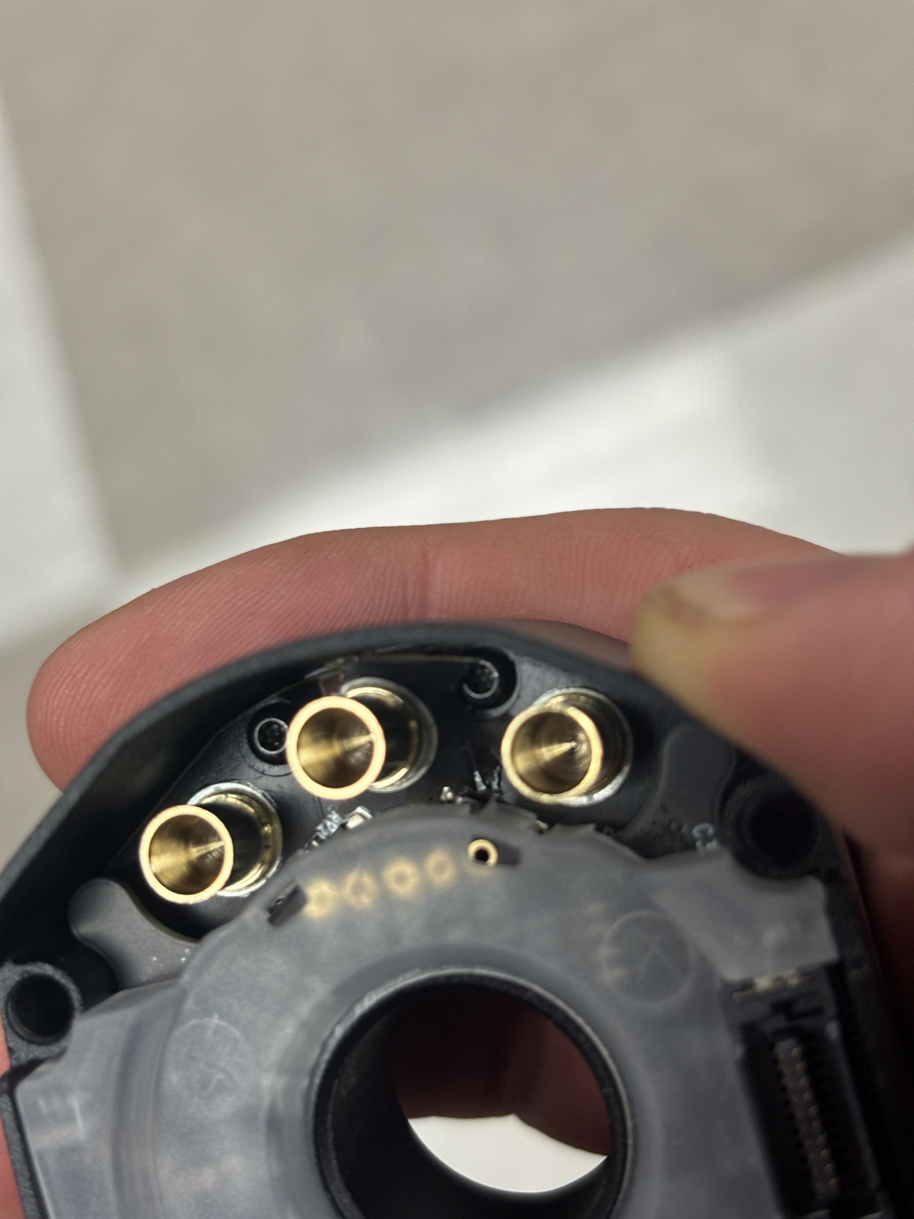

So I was able to investigate the first broken Spark Flex, and it seems like there’s some apparent damage to the circuit board around the middle pin. I’m still not sure what could cause this damage, and why it happened twice (maybe a weird pin on a vortex, or being crushed somehow by mounting?) There was zero damage to the 6 mounting holes, confirming that the bolts we used were the right length. Have any other teams experienced this failure state, and what causes it?

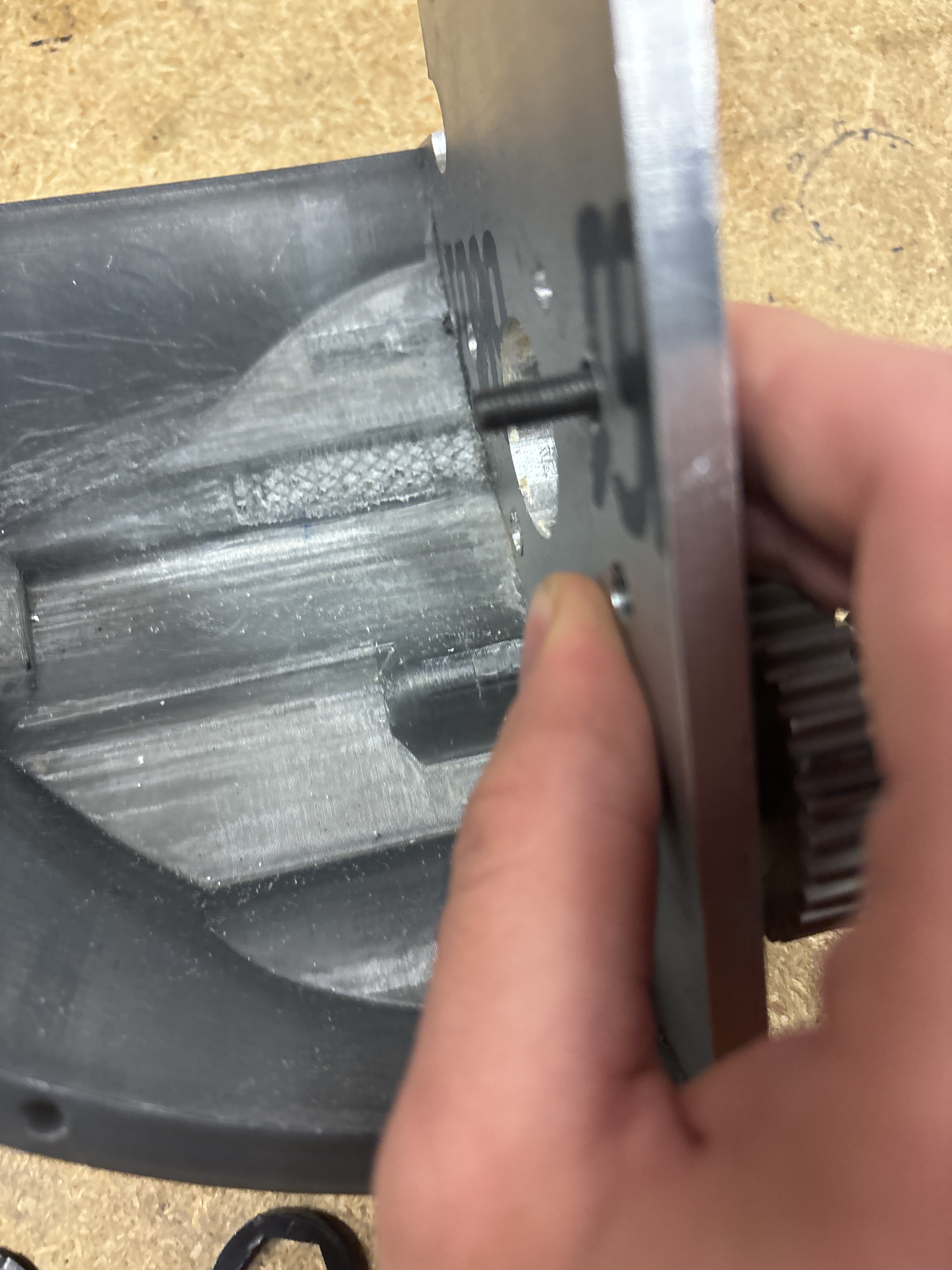

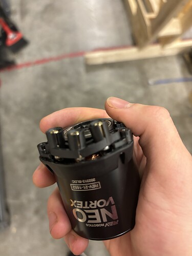

Update: Never trust your build people. The screw depths they used went .5 in into the spark flex, not .25 in into it. Total damages: 280$: 2 flexes and one vortex. Take this as a cautionary tale.
