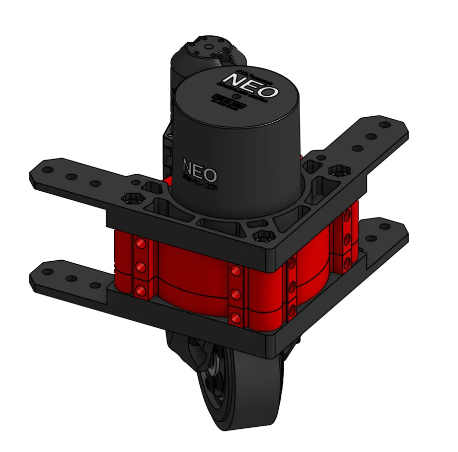

Since so many teams are using swerve this year, thought I’d share a MaxSwerve cover design I made in the preseason

Updated this design:
  • 2 piece design to allow for access to gears while fully assembled (greasing, inspection, etc.)
  • Exterior heat set mounting holes (M4/8-32)
  • Corrected encoder cutout, turns out my team had assembled the modules wrong
Download at the same link
