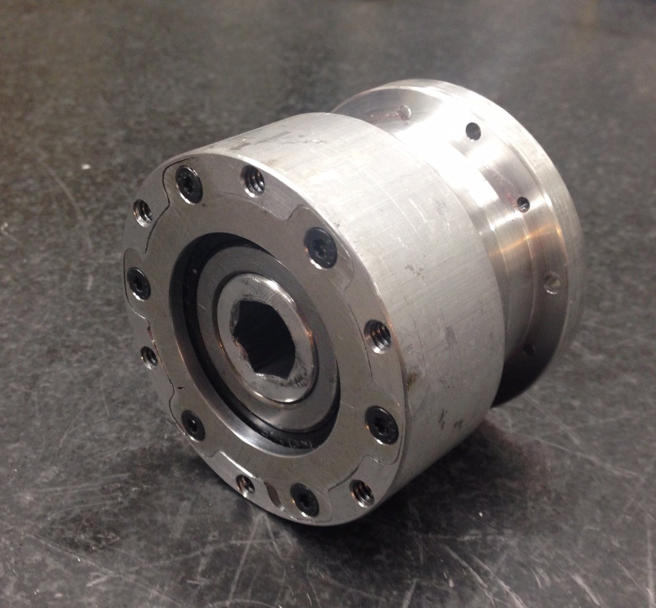

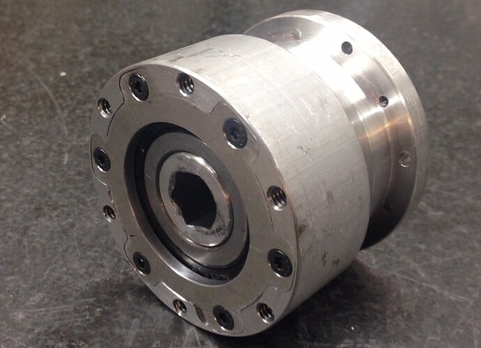

As for the efficiency, I really don’t have the right equipment to measure that right now. It is abs plastic and it’s not melting, if that’s saying anything.
Attached is a picture showing whats going on inside. The gearbox ended up being pretty simple, kind of ironic considering the path it took to get to this point.

Do you have any maximum torque figures?

This gearbox is known in the industrial robotics industry as an epicyclic gearbox and is very common in robots that require low backlash and high gear reduction.
A couple of business and technical points:
  1. There are MANY patents on this design. Several of them have expired but a few key ones still exist so do a patent search before selling this.
  2. This design looks to only have one stage going in a single direction. This will induce severe oscillations that cause torque ripple which are detrimental to high load arm applications. There are ways to solve this but it adds significant cost.
  3. In order to get acceptable efficiency the oscillating gear must have a very smooth surface finish. Grinding that surface is a must or I would not use it. Plastic gearing for this will severely limit the load carrying capability.

Michael, I torqued the gearbox unpowered with some lever arms until it broke apart. I would estimate that it reached around 50 ft-lbs.

Paul, I did some patent searching, I couldn’t find anything that the design violated, If you know something in particular that may be a problem I would welcome any information. I haven’t experienced oscillations besides having to counterweight the input cam/oscillator. Plastic gears do have their limits, obviously I wouldn’t recommend this for an industrial robot, but for FRC robot that needs to run for limited amount of time, I believe it can work.

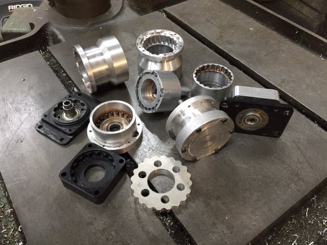

These drives are very cool…I’ve been working to create a useful one for about three years.
I haven’t released a unit for FRC because of the immense challenges.
I won’t detail them here, but I will tell you that we have a “large” box of failed iterations. :eek:
I’ve attached a picture of a 400:1 unit with a 2.5" OD and an 8mm CIM input.
Here is a video…these are from May 2013.
http://youtu.be/tJoWlCDmaLg
I’m in the sharing mood…table of previous design iterations. I’ve been working on these for a long time.

Great looking gearbox. I’d love to hear more details on what kind of failures you ran into when going through different designs. I suspect that you need pretty tight tolerances on all of the parts so you land somewhere between “too tight to assemble” and “tore itself apart”.

I did some measurements and testing on the gearbox, particularly on the 168:1.
Weight came to 1.1lb (0.5 kg)
Backlash was 1.1 degrees
Efficiency was a bit trickier. I have a supply that has 3 different power settings and a very course amperage meter. I put a volt meter across the leads when I ran with a bare motor and then retested with the gearbox (no load). I did this with 2 different motor / gearboxes and in both directions. The voltage across with the gearbox was around 9, 12, and 14 volts, so I think the efficiency was hurt a little bit by spinning faster than what would be seen in normal operation. Without putting a ton of data down, the average of the results for efficiency under no load came out to be 61%. All but 2 of the results were +/- %7 from this.
I would expect that the values for the 264 and 552:1 should be very similar to the above.
