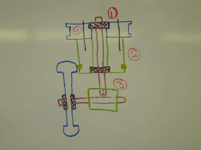

The Julian friction gearbox design solves the two main weight issues with gearboxes by removing the gears and the box. Society has finally progressed past the need for gearboxes, but some people are just stuck in the old ways.
Just machine yourself a bunch of little torque converters and enjoy the benefits (?) of a fluid coupling.
This thread seems as good a place as any to say that we actually ran a friction drive in 2009.
I can’t find a good picture, but we did actually build the thing.
