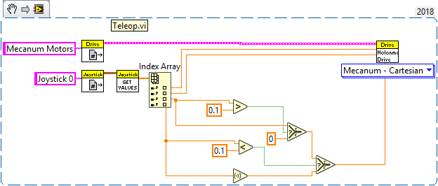

I think this does the basic, without the bumper spin.
The left joystick should do forward/back/strafe
The Triggers should do spin clockwise/counterclockwise.
If this works as you want, then we can add the bumper spin to it.
MechanumControls1
All this assumes the wheels are setup correctly and the motors are setup in Begin the way I expect (expectations can be wrong).

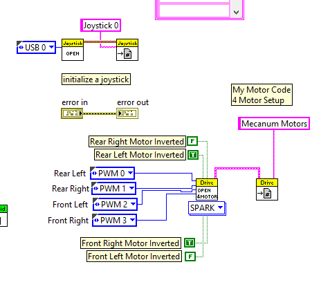

Here’s my begin code begin%20motors
I don’t think you should be inverting any of the Mechanum motors, and certainly not one from each side.
Assuming of course that all the motor controller/motors are wired the same way and don’t have crossed wires.
I originally had none of them inverted but when we did joystick right it went forward so our electrical guy said to do that.
Everything is working great with your code, I just need to half the speed of all motors now.

For the strafe vs spin, try switching the axis zero with the final result of mixing the axis 2 & 3.
To cut the motor speed, multiple all three inputs to the Set by a percentage (0.0 to 1.0), e.g., you’d get 80% power by multiplying by .8
Where in exactly in TeleOp would I do this
I’m not sure why the strafe and rotate are swapped, but you should just be able to swap the controls.
Well, at the risk of getting confusing, here’s that code
  • With bumpers added
  • Swapping the Left stick X axis for the Trigger outputs.
  • Adding in the bumpers to do the same thing as the Triggers
  • Reduce power to 80% (you can change all the .8’s to any other percentage to get more or less max power. You could even apply different power to different controls if that works better. A value of 1.0 will return it all to normal.
The triggers are variable power based on how tightly you squeeze them, but the bumpers are just on/off buttons, so the buttons operate by only applying full power.
That’ll get reduced by that 80% power in this example.
MechanumControls2
