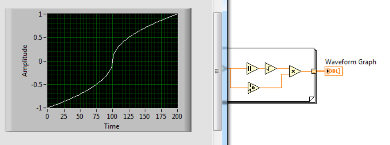

Rather than the stepwise adjustment, you may want to consider using square root. The attached image shows the plot from -1 to 1 and the code that preserves the sign of the square root of the input number.
Greg McKaskle
Greg McKaskle
Thats a really smart idea that I hadn’t thought of… I’ll definitely try it out at our next build day!

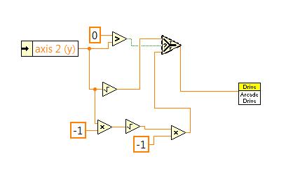

Just in case though, so I can have more to play around with, would someone mind explaining to me how to fix the pic above? I know the orange wires are double/numeric values and the green wires are boolean values, I just don’t know how to set up an if-then-else-if sequence
EDIT: Also, another question… Whenever I deploy code OR build the code, I get this pop-up every single time. I don’t really understand what it means, but I just click okay and it deploys/builds perfectly fine. Should I just leave it alone or should I do something to stop it from popping up? (attached pic)
The red X with the arrows pointing in away indicates no source on the wire. You have the wire going between two data consumer with no data source. If you hover over the X or use the context help window it will give a similar explanation.
To fix one of the cases, the code for 1.5X joystick is always wired to the motor, but you really want it wired to the <0.4 selector. And the multiply has a 1.5, but it doesn’t have the joystick value wired to the other input. Branch the wire at the <0.4 and hook that up to the multilply as well.

So I’m trying to modify our drive system. I tried just plugging the output into a sqr-root vi and that into the drive system vi, but as soon as I enabled the driver station, the wheels immediately turn. I’m pretty sure it’s vecause it’s trying to take the sqr root of 0, so I’m trying to code it so that it’ll work for everything, however I’m still confused how to do if-then-else statements in LabVIEW
I attached a picture of my attempt to make it work for positive and negative numbers (but still have not set it to “if == 0, go straight to drive system vi”)
Also I’ve heard something about case structures for if-then-elses, not the “select” vi, but I’m not sure which to use how to use either one…
Thanks for the help!
Taking the sqrt of zero shouldn’t really cause an issue. You may find it useful to probe the wire you are sending to the motor. And if you are not comfortable with it, you can copy and paste the code to another VI that runs on the host and plot it as I did a few posts above. For the task you are looking at, the Sign and Absolute value functions are pretty handy.

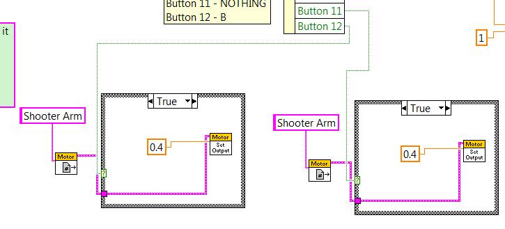

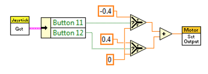

We had a huge issue today. Spent a good half hour to an hour trying to figure it out and still never got anywhere, AND apparently last year’s programmer never could figure it out either. We have a window motor (for our shooter) that I programmed simply:
Button x: if true, set motor output to 0.4 / if false, set motor output to 0
Button y: if true, set motor output to -0.4 / if false, set motor output to 0
I used case structures for both and copy/pasted the first one made and just added the (-) sign. However the issue is that only one of the two Case Structures will work! Say (ex) initially, Case A is +0.4 and Case B is -0.4. Case A will move the motor but Case B won’t do anything at all. Then I switched the signs and Case A will move the motor the other way, but Case B still wont do anything. Switching buttons didnt make a difference. If I delete Case A, THEN Case B works, since there’s no other Case in its way.
I tried it both with one and with two RefNumRegistry Get vi’s but that didnt make a difference either.
Pics of the cases attached. The FALSE sides are identical to the TRUE sides, except the number is 0 instead of +/-0.4
Triple click the Boolean wire coming from the Button. Delete it and rewire it. I suspect that you have one wire that just looks like it comes from 11 and another that comes from 12.

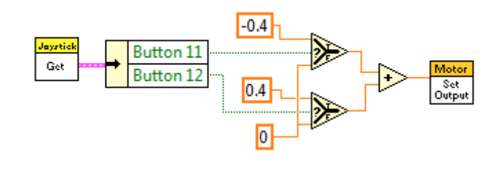

I again encourage you to have fewer icons to set the motor output. If you know that you will set it, just not sure what value, only make the value selection conditional. Code as you have written it has a tendency to evolve to the point where it is accidentally setting the same motor to 2, 3, or 5 different speeds during a single teleop frame. The winning speed is who went last, and it seems possessed.
I attached an image, definitely feels like I’ve drawn it before, that demonstrates what I mean. Note that in the case both buttons are pressed, you have to declare what to do. I chose to sum the speeds and the motor will not run. That may be a bad idea, but you have to decide what to do in that case.
Greg McKaskle
They’re both working fine. The problem is that one of them does something first, and then the other one immediately does something else, so what the first one did never has a chance to make itself seen.
What you’re trying to do is easy, just not with parallel Case structures like that. Greg’s code is simple, quick to implement, and hopefully easy for you to understand.
yeah, using select vi’s instead of case structures worked perfectly, and is easier to understand ^^ And somewhat ironically, as soon as I checked that the Select vi’s worked here, I went and programmed an addition to our drive system using a case structure, which worked fine. (I set it so that when a button is held down, to multiply the axis output values by 0.25 so we dont have to jerk the controls when aiming for a shot)

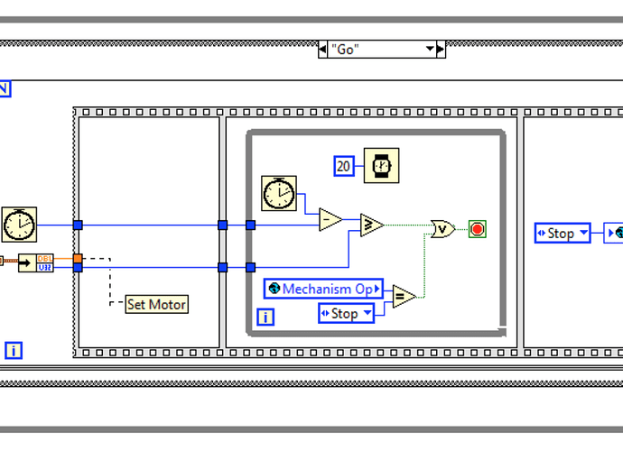

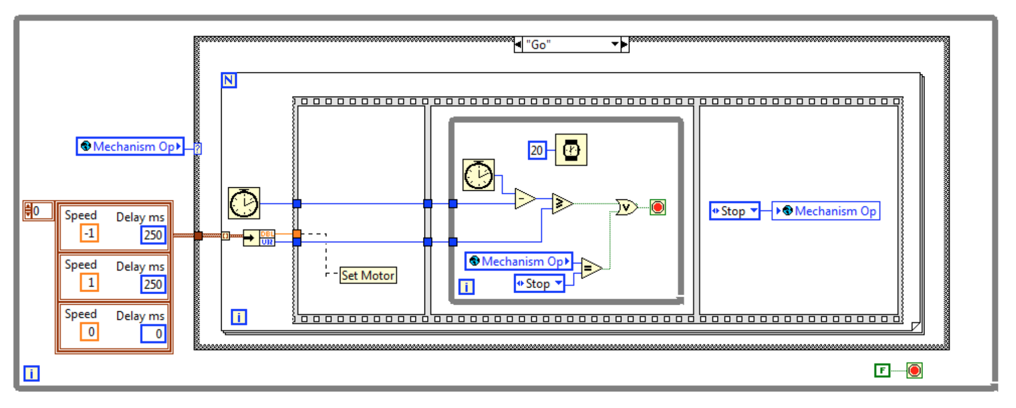

I’m trying to figure out how to wire “-1 for 250 miliseconds, then 1 for 250 miliseconds, then 0/nothing” into a Set Motor Output vi’s output node, but I’m not sure how. Which Vi(s) should I use? I’ve found Timed Sequence as well as all different kinds of Wait and what not
You don’t mention whether this is for autonomous, teleop, or more general. I’ll give some options and try to explain the tradeoffs.
In autonomous, no other code is running, and there is no need to return to the scheduling code. This means that your code can be written the simplest. You can use a sequence and in frame 1, Set Motor to speed S1 and delay with D1 in parallel. Frame 2, Set to speed S2 and Delay with D2, etc. You can generalize this to use a loop and an array of S1, S2, S3, and D1, D2, D3 if you want to.
In teleop, your code needs to return to the scheduler every 20ms or so. The delay block prevents this until the delay is over, meaning that your joysticks will be frozen for a few seconds. The way to code this in teleop code is not obvious, but a trick well worth putting in your tool chest. It is called a state machine. You code it by Setting the motor and noting when you started it. You update the state to Running A and let the function finish and return to the scheduler. Each time teleop is called, you check to see what state you are in. If in state A, you compare the current time to start time to see if 0.25 seconds have passed. If not, leave it alone. Once 0.25 seconds have passed, you change the motor speed and set the state to B and let it return. B does the same time compare and eventually goes to state C where it stops the motor.
The third option is to put the code into Periodic Tasks and let auto and teleop communicate to it. When in Periodic Tasks, you can write it simply, like autonomous, but you put it in a mechanism loop so that it is started/stopped/canceled by a global or other communication mechanism. This is actually the approach I’d generally recommend, and I attached an image of the general code that would be pretty easy to duplicate and set to other mechanisms. The other case handles stop and delays for 20ms. Look through the code and see if you see any issues or have any questions.

That’s very helpful, thanks! I’m trying to copy that into my periodic tasks but I don’t recognize a few of those VI’s. What is the array looking thing on the left? and the Start and Mechanism Op VI’s? Also, I put it inside a While loop, but I don’t see the slot at the top where “Go” is in your picture either
