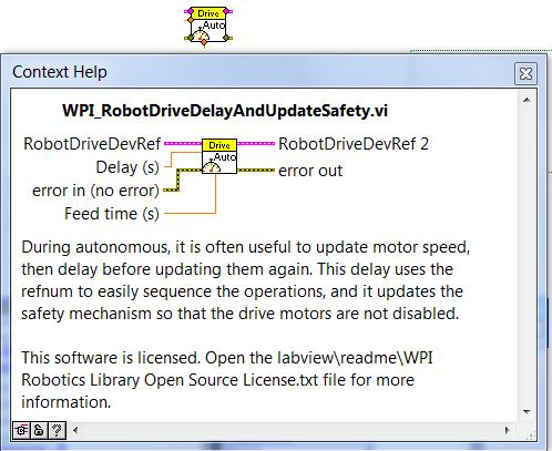

EDIT: Is there one of these VI’s that is a MOTOR vi, not a DRIVE vi? That would make things WAYYYYYYYYYYYYYY simpler, and easier to understand. Pic attached
After you’ve placed the enum control, right-click on it and choose Properties from the popup menu. Select the Edit Items tab. You can insert new items and rearrange the items in the list. The “Items” column holds the name of the enumerated values; you can double-click on one and edit it to be whatever you like. Greg picked “Stop” and “Go” for his example.
You don’t need a combined “drive and delay” vi for a motor that has the safety disabled. Just put a Delay in the frame next to the Motor Set Value.
The only timing VI’s i found besides that one are all seemingly independent. The one attached above wires directly to a drive system. So I need one to wire directly to a SetMotorOutput vi. Or if not, then I don’t know how to use one. Once again, all I’m trying to do is:
  1. Send a motor control the value of -1
  2. Wait 0.25 seconds
  3. Send a motor control the value of 1
  4. Wait 0.25 seconds
  5. Send a motor control the value of 0 (and leave it that way until I call this function again)

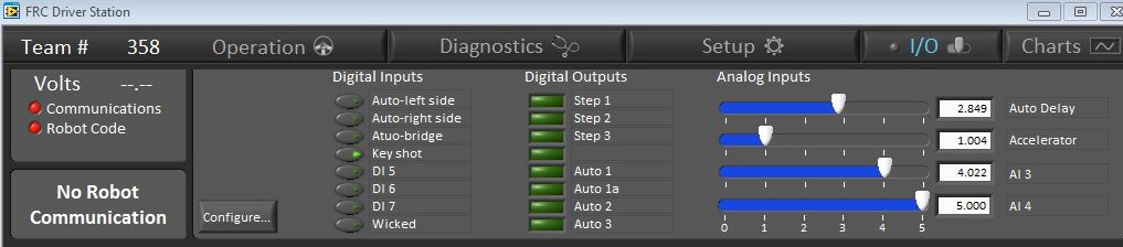

But now I’m starting to get into Autonomous programming. I think I understand the coding part of it fine, but I do have a few questions about the general use of Autonomous mode:
  1. I was told you can have up to… I think it was 10? different Autonomous modes. At competition, how do I choose one before the match starts?
  2. When practicing during the build season, how do I simulate the Autonomous mode part of the game? Do i change the drive station to Autonomous, Enable, and after 15 seconds it will automatically flip over to teleop, or is it more complicated than that? I’m unable to test anything with our robot at the moment but I also don’t want to accidentally mess anything up

There isn’t a limit on the number of discrete autonomous routines you write.

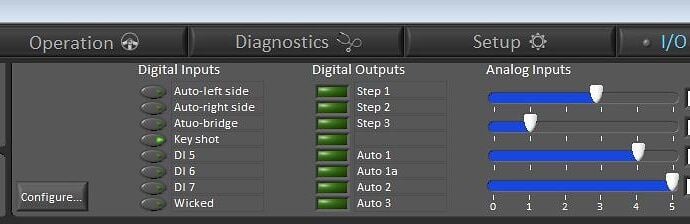

You can choose the mode to run from the Driver Station, using the I/O tab, or wired selectors, or by choosing with a button press or a sequence of presses.
You can install a switch on the robot itself to choose between autonomous modes. Switch values are available in your cRIO code. Lots of options.
Choosing Autonomous mode on the Operation tab will just run Autonomous mode as long as it’s enabled. No time limit is imposed.
Using Practice mode will by default go through a typical field cycle of Disable/Autonomous/Disable/Teleop/Disable. Options are provided on the Setup tab to adjust the times, so for instance you can reset the Teleop period to be 0 seconds if you don’t want to bother with that mode, but still get the Autonomous time limit and other transitions.
Awesome, i played around with the drive station and understand that part.
Still a little confused how I can tell the drive station or robot to pick (ex) Autonomous Mode 2 of 5. So if we wanted we could have an Auto Mode for the back of the period and the front, and choose between them at the last minute.

And also how to separate multiple Autonomous Modes in the programming
Either use the Dashboard to set a value that you then read on the robot using the SmartDashboard functions, or just use what’s on the I/O tab of the Driver Station.
Turn Autonomous Independent into a single large Case block. Put each mode’s code in a separate case and use the value you receive from the Driver Station (or the Dashboard) to select which case gets executed.
