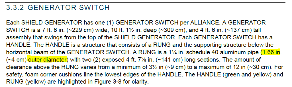

The manual says that it’s a 1 1/4 inch aluminum bar, but never specifies diameter or radius. Does anybody know which one it’s talking about?
1.66 in OD
1-1/4" schedule 40 aluminum pipe.
Pipe size is measured in the nominal interior diameter, schedule 40 defines a thickness, arriving at the ~1.66 OD provided by typeusernamehere.
