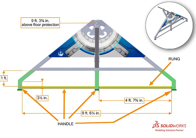

Would attaching both ends of the generator be against the rules? For example, the middle, vertical bar on the generator switch, would you be allowed to attach to the horizontal bars on either side of it? Or are you only allowed to attach to one side?
Rule book says nothing about how you climb in terms of sides
Thank you for the quick answer!
This answer isn’t as quick but it may be helpful - rule G26 states that you can’t attach to those horizontal bars, as they are not technically part of the “HANDLE”:
G26. Be careful what you interact with. ROBOTS and OPERATOR CONSOLES are prohibited from the following actions with regards to interaction with ARENA elements. Items A – C exclude POWER CELLS, HANDLE, and the ALLIANCE’S CONTROL PANEL. Item G excludes the HANDLE.

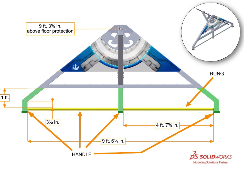

I believe you are reading the rule incorrectly. The enumerated items A - G are things you can not do to most of the field. “Item G excludes the HANDLE” means in fact you can suspend from the handle.
However, you need to understand what makes up the HANDLE. The RUNG is the lower horizontal bar. The HANDLE comprises this plus the GREEN highlighted structure. The upper horizontal bar (parallel to the RUNG) is not part of the HANDLE. Thus G26 applies to it.
