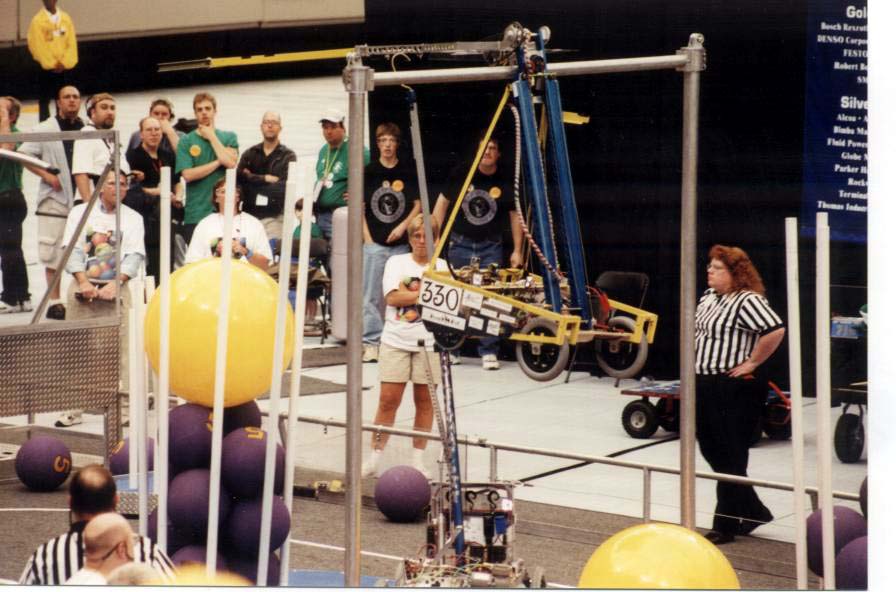

Double climb off the center with a alliance robot on your side/back/front jutting out perpendicular to the bar like 118 last year.
Who would try that?
