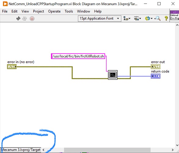

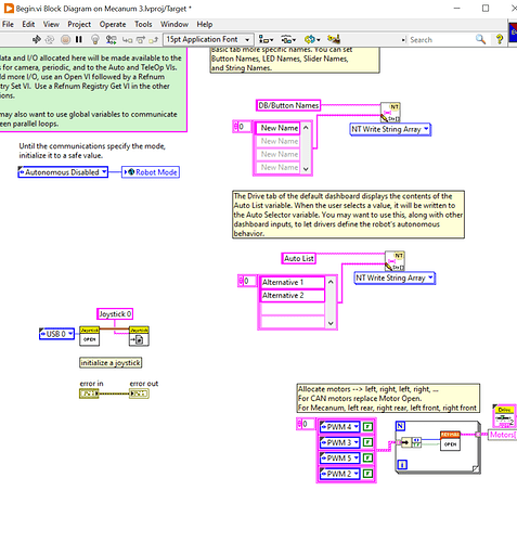

We are having the same problem. Only we can put the program on the roborio2 but when we open the program again it is broken with these same errors. The NT Write String array in the 1st picture is where the error is located. The second picture is the root cause.
What target is selected if you click at the circled spot?
When we switch it to my computer the arrow is no longer broken. But, that does not help because we would just be building to the computer. So, maybe it is an error with the Roborio? However, we did not try the Main Application Instance. They are going to try to reimage the Roborio real quick

It is hard to be sure, but I suspect there are several issues involved here. I will list a few conditions that can cause errors, and hopefully they will help diagnose what you may be running into.
  1. The game tools installer this year didn’t seem to do a good job of removing old files before installing new. The results was that you could end up with a mash of old and new files. If you never uninstalled gamed tools, perhaps it is worth removing and installing game tools. Your LV installation should be fine.
  2. Templates that shipped in prior years were built to target a myRIO product instead of a roboRIO. These are close-cousins, but now and then, it would cause the SystemExec to break the VI. This is the black >> subVI. New projects use a roboRIO target type, and you can drag files from old to new project pretty easily.
  3. Especially if Network Tables functions are busted, be sure that the target you are using is images for 2023 v3.1 or greater. This year’s NT is totally new and will not work on older controller images.
If you have other issues, please post the error from the broken arrow or build.
