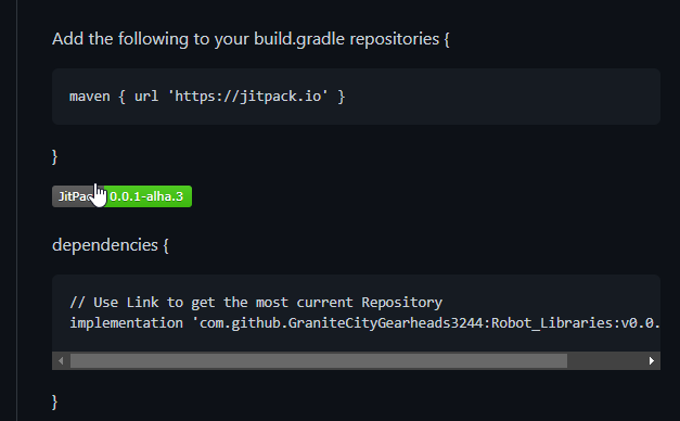

I am in the process of getting the limelight setup for distance tracking, however I am stuck. Apparently there is a library or what some have called a wrapper that you need to get setup to call some commands from. However so matter what I try I cant find anything to get it into the project. One thing said to add some lines to the build.gradle file, but on a previous project that our old programmer did has the limelight stuff in the file, but nothing is changed in the build.gradle so I’m lost.

I am able to get the Camera displayed to dashboard, but I am trying to get this installed. Library
From a separate topic, I was shown a command to estimate distance, however it requires a function that is found in that library, and I have no idea how to get that set up. The function I need is the getdegVerticaltoTarget.
So this is a teams repository that they shared. 3244 is a great team. Have you read their readme file? They told you what to do with your build.gradle file.
With that said, you could just copy their limelight class file to your project as well.
I’ve tried doing what it says, but I have not done any maven or gradle work so I do not know how to do what it says. Our old programmer left so I’m trying to learn everything from scratch. This is the template I am building off of. It does not have an allprojects section, so do I create one, or just add both of those lines into the dependencies?
With that said, by copy, what do you mean? The project I am referencing is our old infinite recharge stuff and it has a whole new folder outside of the frc stuff so do I just copy paste that file directly over and let the maven/gradle stuff do all the rest?

With that said, I’m not your coach, so I don’t mind telling you how to copy the 3244 library dependency you mentioned above:
Assuming you’re using java, you should ALREADY have a build.gradle file in your project. Open it up.
Find where it says repositories in the file. if you can’t find it, you can create the line "repositories { } "
In those brackets, ur gonna put what they told you below.
next find the dependencies line. repeat the same steps as above, copy pasting what the say to copy paste into your build.gradle file.
save it. right click it, build it (make sure ur connected to internet)

I am the developer of that library. How can I help?
it is possible the instruction don’t work with the new Versions of Gradle.
You can copy and paste the oi folder to your project from here https://github.com/GraniteCityGearheads3244/2019_Jupiter/tree/master/src/main/java
