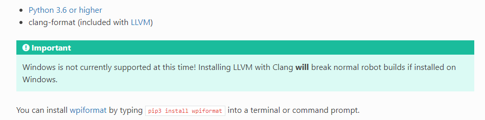

After going back through the instructions I see that I needed to install clang-format (included with LLVM) and then I re-read the big important message in the green box saying, don’t do as it will break everything.
So, are there any work arounds or is it just not achievable for the C++ language autoformatting on Windows computers?
Manually putting just the clang binary in your path will work.

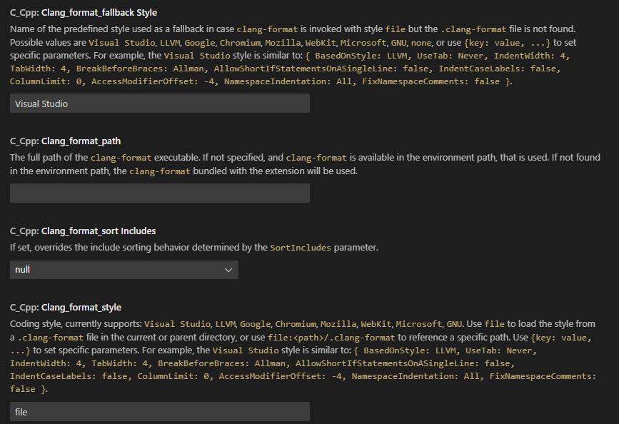

In VS Code, you can customize the formatter by going to File > Preferences > Settings, and then navigating to Extensions > C/C++ > Formatting
The default seems to be to use clang-format with the settings in .clang-format in the project root directory. So it’s probably as simple as putting the wpilib .clang-format file there.
Since the C++ extension installs it’s own version of clang-format (14.0.6) you can probably just add C:\Users\Public\wpilib\2023\vscode\data\extensions\ms-vscode.cpptools-1.13.8\LLVM\bin to the path without installing anything extra.

I had a look in the VS code setting you mentioned and there are a gazillion of them, I’m not sure where I’m supposed to put wpilib .clang-format
Here is a screen shot of the first few setting
Do I still need those three files mentioned in the wpilib docs on formatiing in the root of the project?
