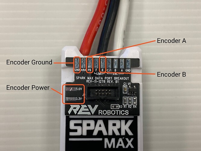

So I’m a slightly experienced coder and have been working on this Swerve Drive Code for a while. I have been able to successfully set up all the required code using this video and modifying as needed (https://www.youtube.com/watch?v=0Xi9yb1IMyA&t=310s&pp=ygUSaG93IHRvIGNvZGUgc3dlcnZl). I’m still having the issues of the modules not aligning though and I am not sure what I am doing wrong. I am using the PG71 motors with TalonFX for the modules. The PG71 motors are the turning motors and are hooked up to the spark max breakout board in alternate encoder mode. I’ve been struggling with this code for about a month and would be very appreciative if someone could help me figure this out.

This is the configuration we are using for the spark max. The only issue is I believe we have to use the alternate encoder with the way the breakout board is setup.
so, spark max with 775 with quadrature encoder on pg71 gears? one thing to check is the encoder output, which you can check by hooking it to the Rio DIO directly. it’s also possible to connect the encoder board backwards. what’s the exact symptom?
I believe I am having trouble understanding what you are asking, there does not seem to be any issues with the encoders currently. Normally the wires would hook up to the dio ports on the roborio, but we decided it would probably be easier and more manageable if we used the breakout out board on the maxes. We are using the spark maxes in brushed mode because we the pg71 motors are brushed. I was just questioning what you meant by ignoring the alternate encoders. Now that I am looking closer at the documentation, it may have just be better to go with the dio ports instead of the breakout boards.

Oh ok, I apologize, so we do not actually have analog encoders on the robot and I am not sure why I did not see that before, we only have the encoders that that the pg71 motor came with hooked up to the breakout board and the built in talon motors. I wasn’t thinking very clearly while coding this at the time obviously and I was pretty much just following along with the video
