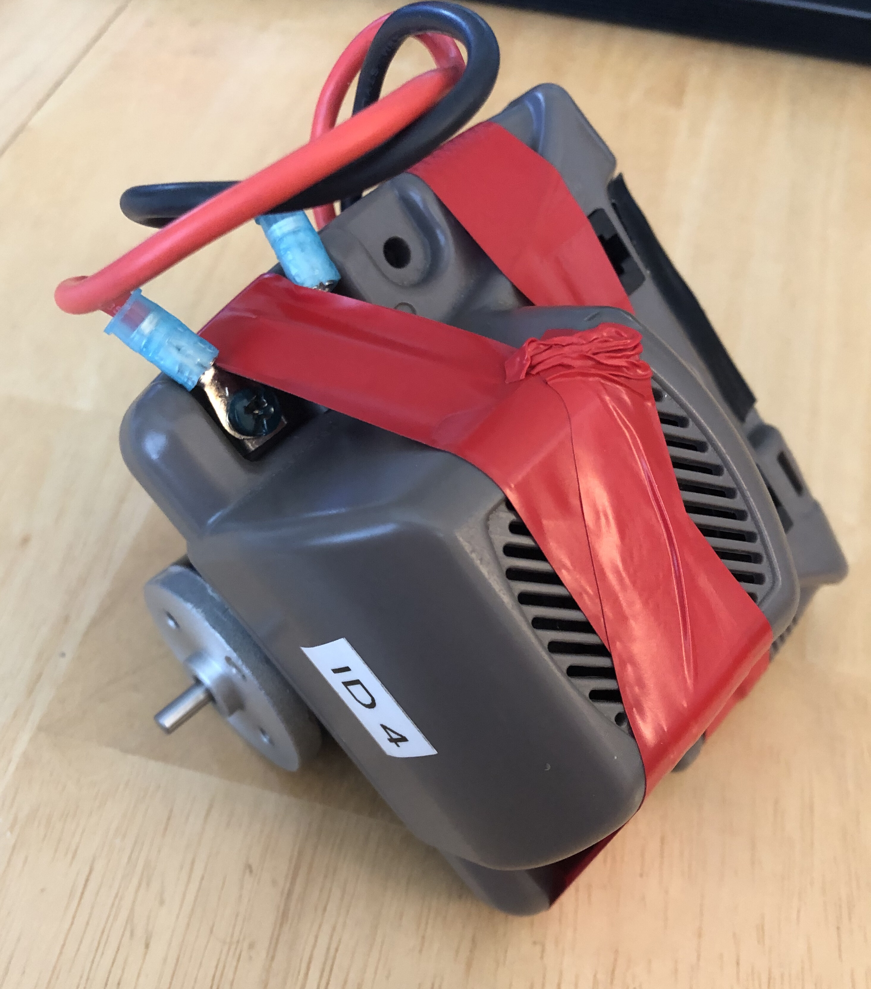

Good news, all rookie FRC teams will be receiving first generation Jaguar motor controllers in their kits!
That is SO MEAN to those rookies!!!
c’mon man, it’s 2021
Give them a BAGuar
