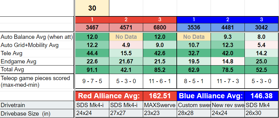

IMO your scouter app interface should be as minimal and “chunky” as possible. You want your scouters to focus on the match, not finding the right touch target. Your analysis on the other hand should have a good way to filter to the teams in your next match for strategy purposes.
Even better your app should look ahead on the schedule, see who you are up against and give you their stats front and center with a recommendation for how to stop/counter their OPR

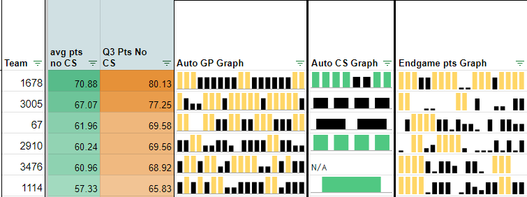

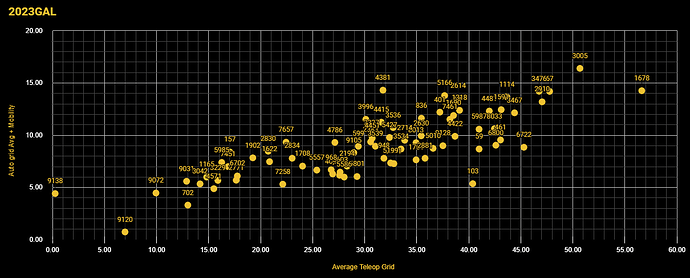

Your Data Aggregation should be:
- Easily configurable by non-programming types
- Excel and Sheets are excellent for this, because they allow you to easily add new metrics to look at that are more valuable for the current moment, like weighted averages, medians, quartiles, maxes, mins, standard deviations, etc.
- Have Graphs
- One good graph tells you so much more than a list of numbers sometimes
- Graphs make it easy to compare teams along multiple metrics at once
- Easily accessible
- Drive team should be able to use the data, scouts should be able to look at the data, and it shouldn’t require one specific person who has all the data to be present.
- This can be difficult to do without an internet connection, so we usually have at least one person in the stands either connecting to venue wifi or tethering to their phone (NOT a hotspot, just tethering), as well as a laptop in the pits doing the same thing.
- Our strategy and drive team will frequently pull up the data on their phones for use in match strategy discussions
There are other features that are “nice-to-haves”:
- Match reference tab hooked up to the match schedule
- I usually manually pull the schedule in, but it’s totally possible to do this automatically. I like doing it manually to reduce total data usage
- Team reference tab with all of that specific team’s match data, comments, and graphs
