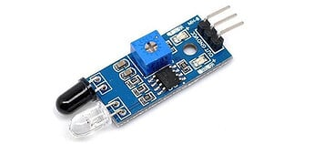

We used a super-cheap (less than $1) boolean IR reflection sensor last year to detect whether we were holding a cube. Something like this.

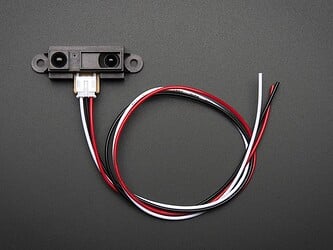

We also used a slightly more expensive (but still very cheap) analog reflection sensor to help us line up with the feeder station. Something like this.

Those $1 IR sensors have served us well.

We also use the Sharp IR distance sensors that have been posted on this thread.
