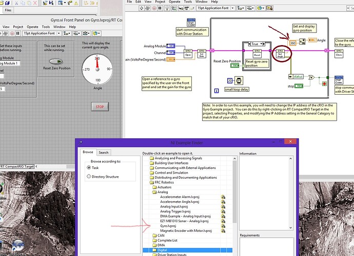

Iām not sure which example you are using, but here is what I found.
If you open LV and click on āSupportā. Then select Find FRC Examples, you will find a Gyro example under the Analog folder.
The Get Angle vi returns two things: The current angle relative to where the robot started, and the current angular rate of rotation.
If you use the āGet Angleā output, I believe you will find what you are looking for.
See the attached image.

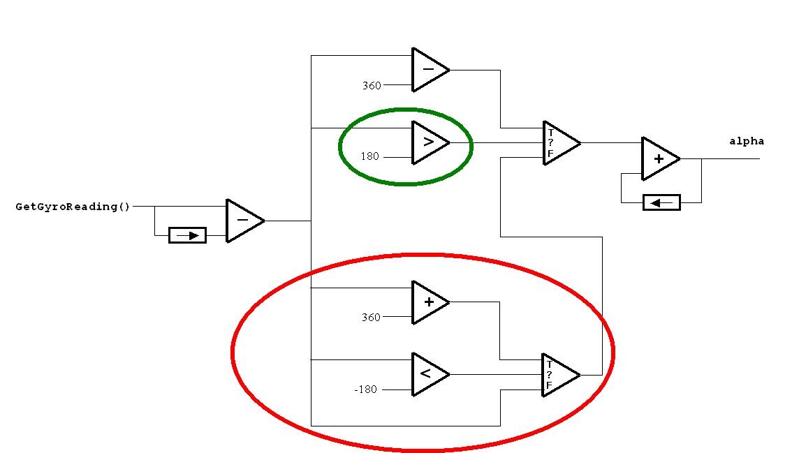

*Hereās a possible implementation of Joeās suggestion.
// initialization:
alpha=Go=getGyroReading(); // range -180 to +180
// iteration:
G=getGyroReading();
d=G-Go;
Go=G;
if (d>180) d-=360;
else if (d<-180) d+=360;
alpha+=d; // alpha is the continuous angle reading you've been asking for

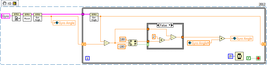

Thank you! thatās what I was looking for.
My goal was to make the simulated gyro work like a real FRC gyro for new programmers training.

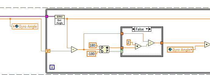

Iāve attached my implementation (this is in periodic tasks)
I implemented the simulation code. The gyro should work the same as a real robot gyro. You should try a real one - if they differ I will fix the simulated. The reason you see compass VIs down within the simulated gyro is because I used subVIs that already existed as part of our robotics module (a separate commercial module that is not part of FRC). For simulation it doesnāt matter what is in the bowels of the code, only that the top layer acts like a gyro.
A real gyro accumulates continuously.
*At runtime if the result of the comparison circled in green is TRUE, does the LABview-generated code still perform the computations circled in red?
There are two types of data flow diagrams, pull and push.
The pull type works from the answer backwards. It determines what it needs in order to compute the result and back propagates to the next layer of what it needs to know. Therefore, it doesnāt need to calculate the red value.
The push type executes the other way around. It starts with what it knows and pushes it to the downstream areas until it has produced the result.
Because LV diagrams contain as much I/O as they do, it was decided to use the push model. This means that side-effects such as I/O in the red area will happen even if the results are not used. If you wish to avoid the red calculations, the technique is to use the switch/case statement.
The other way to determine this ā¦
When a LV diagram executes, it executes all nodes it contains exactly once. That requires both red and green to execute. The case/switch simply decides not to execute one of its diagrams. The for loop, by contrast, executes its diagram N times. Hope that helps.

Applying the above at face value as a general principle: if the portion circled in red was made into a separate diagram, then would that diagram not be executed if the portion in green evaluated to TRUE?
I suspect the answer is that it would still be executed, and the reason is that the green decision is in parallel with the red computation, whereas with the case/switch the diagrams are in series downstream. If that wording is awkward/incorrect, whatās the proper way to articulate this distinction, in LABview-speak?
One more thing: wouldnāt it be reasonably straightforward for the code generator to recognize these T/F decisions, and generate conditional code like the case/switch does? Or would that effectively mean abandoning the push model?
