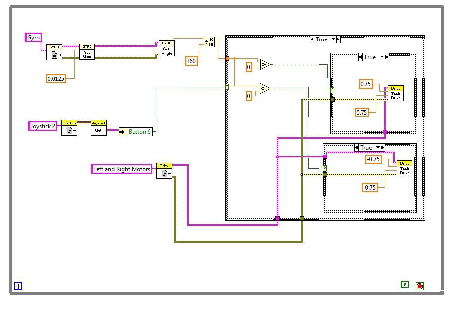

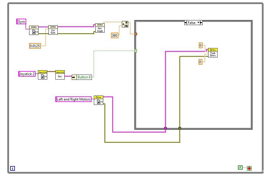

Hi this is our first year in this competition and as a rookie programmer I’ve attempted to write a could to auto balance my robot. Now I may be completely wrong but I was wondering if I did anything right or this could even work when I’m on the bridge.
You’ve got the right idea, but the implementation needs some work.
First - never set motors inside if/then’s like that. The motor set should be outside, over to the right of everything. You should only have 1 of any particular motor set in teleop. This helps to avoid potential race issues.
Next, your case structures should be nested inside one another. This is good coding practice, and helps to avoid extra calculations. There’s no reason to check one if the other is true…
Next, you’ll find this will oscillate around your setpoint. Mechanical systems have momentum, and once it starts moving it won’t stop immediately. It will drive back and forth over your setpoint (probably quite wildly with a motor value of .75!).
I suggested reading some papers on PID’s. That’s what you need to implement here.

A few other things to watch out for:
-As Tom mentioned, nest the case structures and make them manipulate numbers that feed into a single motor command (not just here but anywhere you have motor output).
-The gyro will in practice never give exactly 0; your code as above relies on that to stop the drivetrain from moving.
-If your gyro angle is, say, –20, I don’t know if the remainder operation will output –20 or 340. Unless your robot does a somersault (which for all I know might be crucial to your strategy :D), the gyro you use for bridge balancing will never be out of the range –90, 90], so you should be fine without taking the remainder.

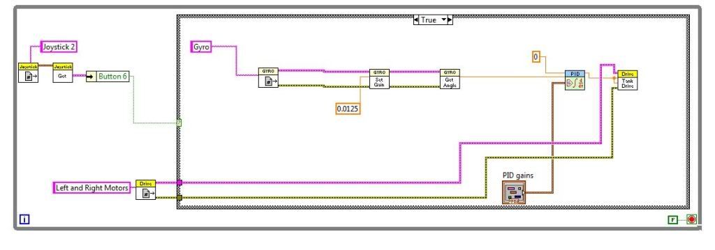

Did I end up getting the PID structure correct…
Yes, but it’s a bit more complicated than that. Keep in mind that the gyro measures yaw (change in angle) around an axis through the gyro itself, but your robot does not balance around this axis; it balances on the bridge. You may have issues because the yaw rate is not directly proportional to the bridge angle.
As mentioned earlier, mechanical systems have momentum; for this reason, a proportional gain will almost always result in oscillation around the setpoint. Because of the double hinge setup for the bridge, however, it has a noticeable resistance to tipping, so an incredibly small P may allow you to successfully balance without tuning I or D, but your robot will be moving very slowly to the setpoint, which could possibly, depending on your wheels/drivetrain, be ineffective due to stalling or slipping. For a time-effective balancing mechanism, you will likely want to tune both P and I.
Searching the forums will yield a wealth of discussion on how to tune a PID loop; there are also a number of discussions about how to tune PI loops and ignore the D.
