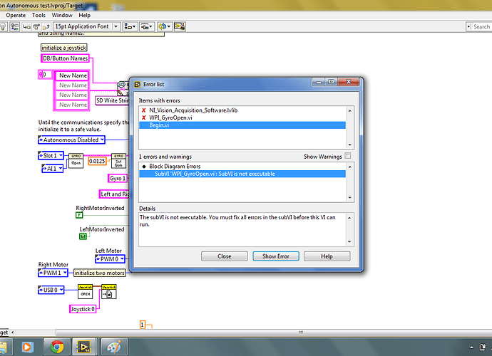

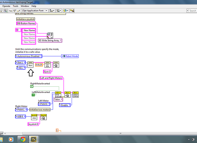

Recently, we have tried to program our gyro but LabVIEW seems to find an error that is setting us back. We want to know if we could get some help with this since this is a real headache pls. GyroOpen seems to be the problem but everything is wired up correctly.
We are using this guide for gyro - https://decibel.ni.com/content/docs/DOC-26313
We can’t see that error unless you show it to us. If we don’t know what it says, we’re not likely to be able to help you resolve it.
…everything is wired up correctly.
Prove it. :slight_smile: Tell us what kind of gyro you are using, and describe exactly where you are connecting each of its pins. If possible, take a picture and post it so we can see what you are talking about.

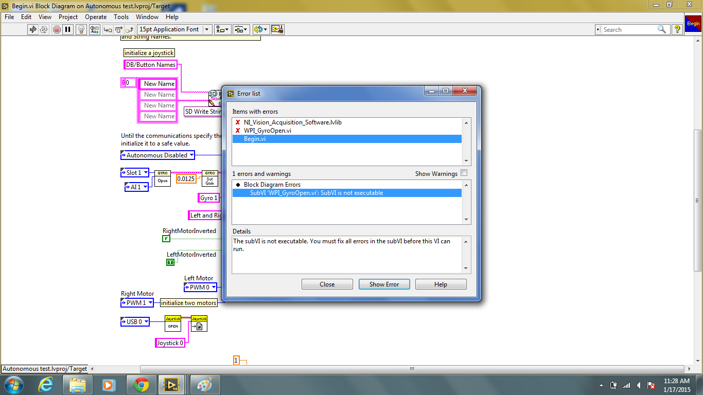

Sorry about that, here are the photos of the problem

That appears to be a cRIO project, because it says ‘slot 1’ rather than ‘controller 1’.
Are you doing this on a roborio? If so, you started the wrong framework when creating the project.

Let me clarify what one of our students is trying to explain so everyone has more detail on what we are seeing.The project is setup as a RoboRio project. So far this is the only WPI library we can not get to work. The Gyro Open.vi appears to not be upgraded for some reason. Our motors, joystick, encoders, digital I/O, Solenoids all compiled correctly. Motors and joystick hardware have been tested on the RoboRio with this code minus the Gyro Open.vi As of right now it is not a Gyro hardware issue because the code will not compile with the Gyro Open.vi present in the code.

I should reinforce what Tom mentioned. It appears that code has an old Gyro vi from last year, as if someone cut and pasted it from old code rather than building it from the 2015 palette.
