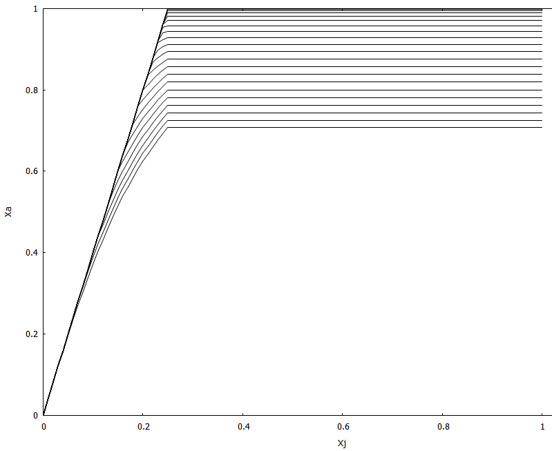

*Instead of using arctangent and exponential functions, why not just multiply the X axis by a factor of 4, clip it at 1, and normalize the resulting X,Y pair?

See attached Excel spreadsheet. The 100 tab shows an overview of adjusted XY pairs (cyan cells) for the entire first quadrant. The 25 tab zooms in for a closer look for small joystick values.
The attached plot shows a family of Xa vs Xj curves for Yj=0 to 1.
