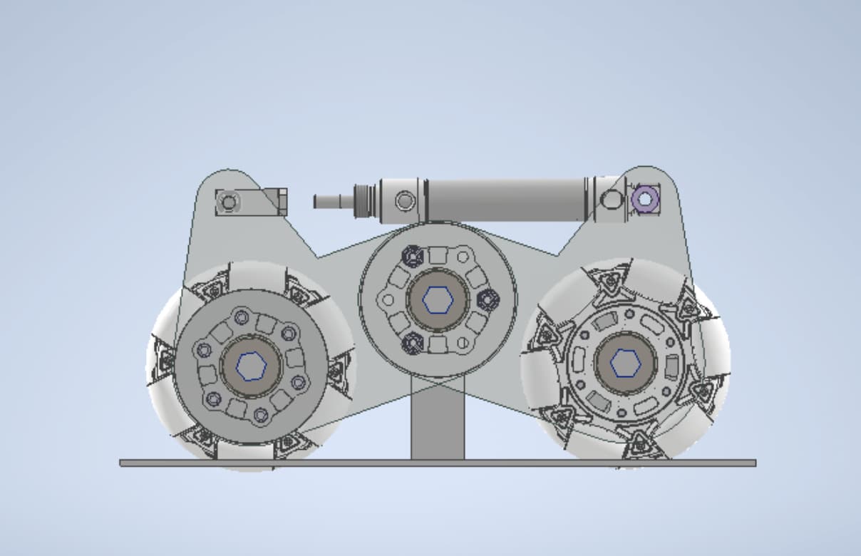

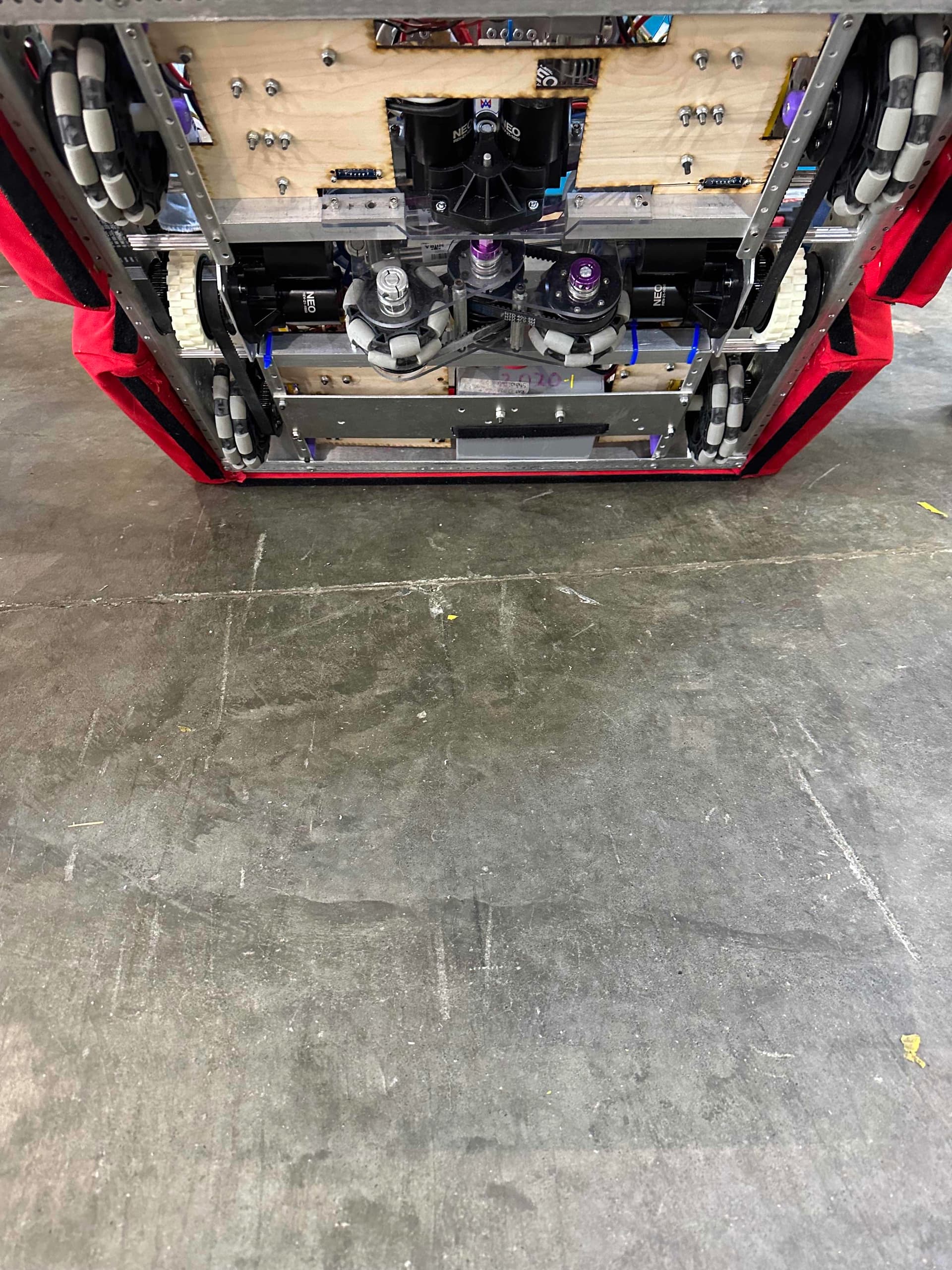

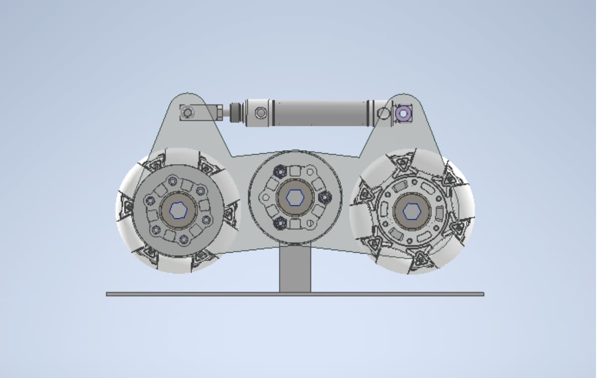

for the off season
Last season (2023) we did H-Drive. We use 6 inch omnis on the tank portion and 4 inch for the lateral. Lateral is attached to a piston so we can retract it for going over the cable cover.
