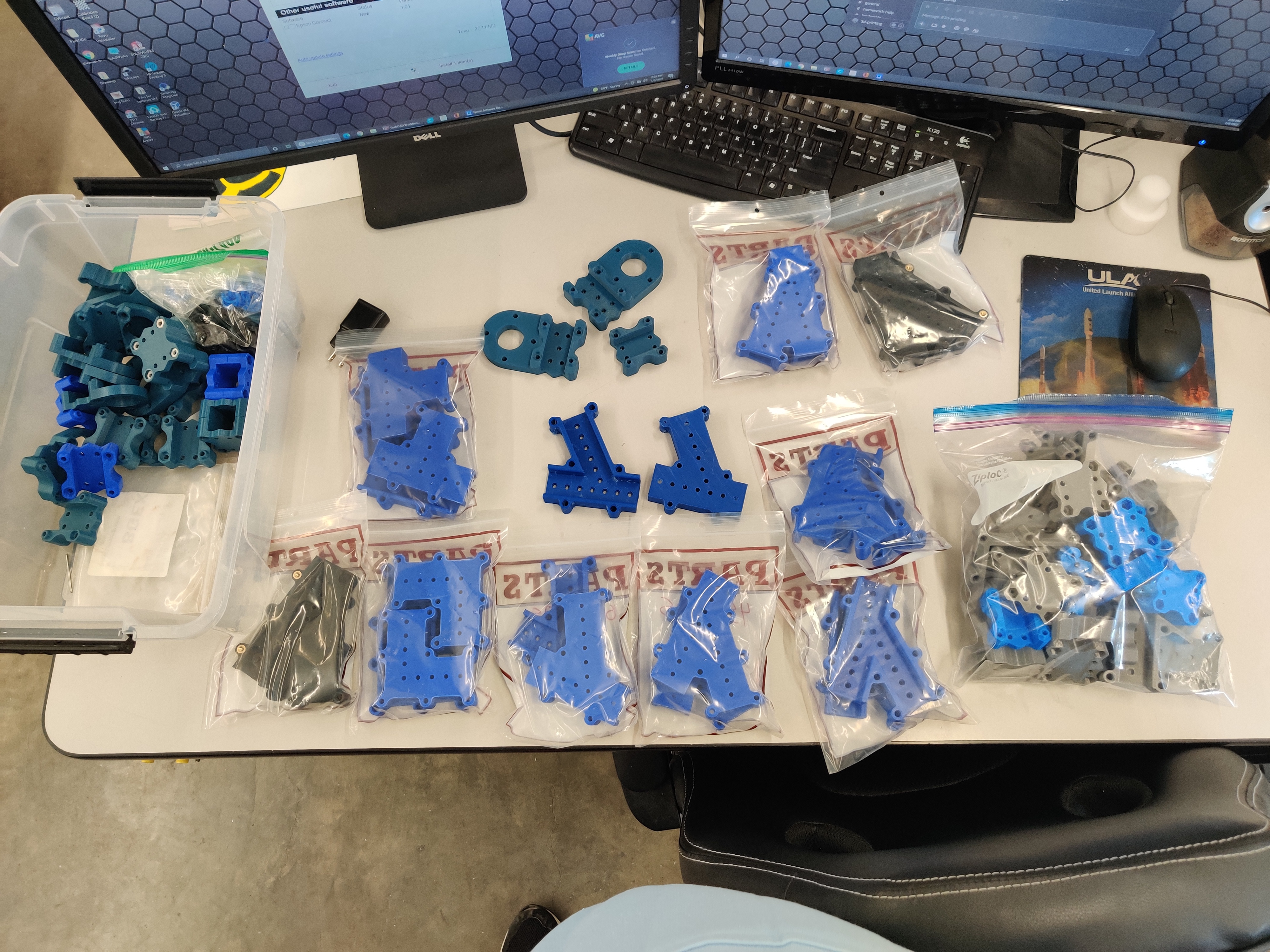

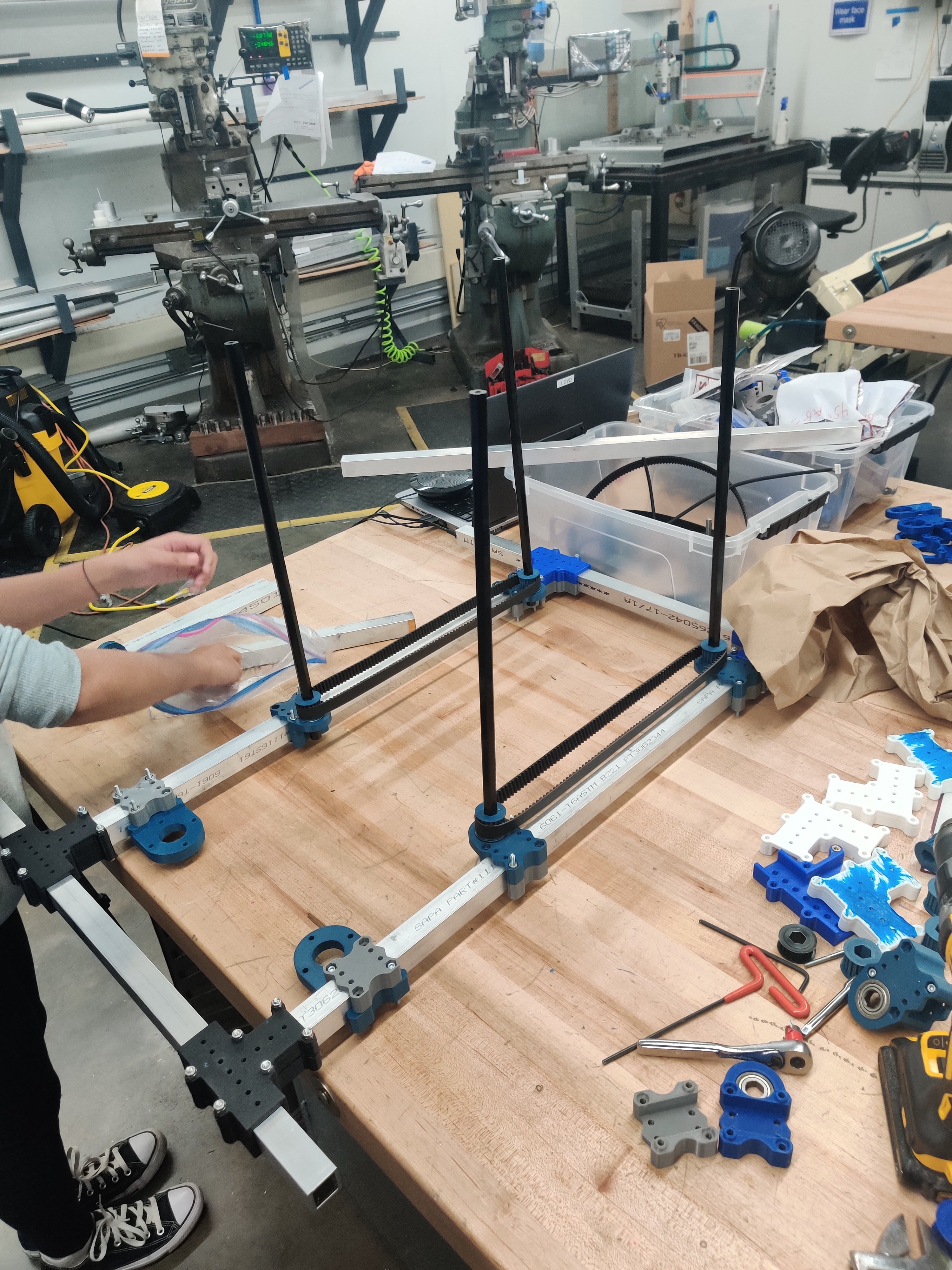

The prototyping systems I listed are physical build systems created by members in the community to allow you quickly throw together subsystems for the purpose of prototyping. These systems typically use 3D printed components and box tubing/PVC pipe for structure.
Here’s some links:
I cannot recommend using a prototyping system like these strongly enough, particularly if your team is like mine and doesn’t have access to a laser cutter. It’s a absolute game changer! As an example, during the 2022 season we were quickly able to prototype multiple different conveyor configurations over the course of 2 weeks, compared to 2020 where we spent 2 weeks getting a single plywood conveyor prototype off the ground.
Here’s a few pictures from the 2022 season of our conveyor prototyping (using a combination of the HypeBlocks and TBB Blocks):
