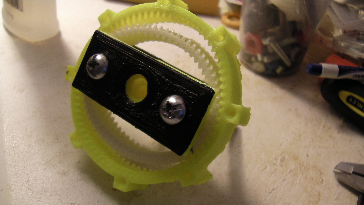

Harmonic Gearbox with planetary inside
Exploring the concept of a Planetary inside of a Harmonic. This is the first draft Print. Learned quite a bit. Will make the flexor a bit large so its less oval - a little thinner maybe (it will get a cup for the output in the final version. And of course this is missing all the brackets etc that hold the motor and the ring and keep the sun in place etc. It was just a test to work out the procedures and math involved to design one of those for 3d printing and explore assembly options. Before I teach it to the kids I need to know what I am doing. Interested to see if the planetary inside can take the place of an elliptic bearing. So far its looking pretty good. This one is about a 40:1 with the less elliptical flexor the next version will probably come in somewhere between an 80:1 and a 100:1 Not too worried about the ratio at the moment just the procedures and protocols needed to be followed to make one. And for now The yellow is HIPS and white bridge Nylon Production versions if we ever get to that will be all Nylon and probably something better than Bridge

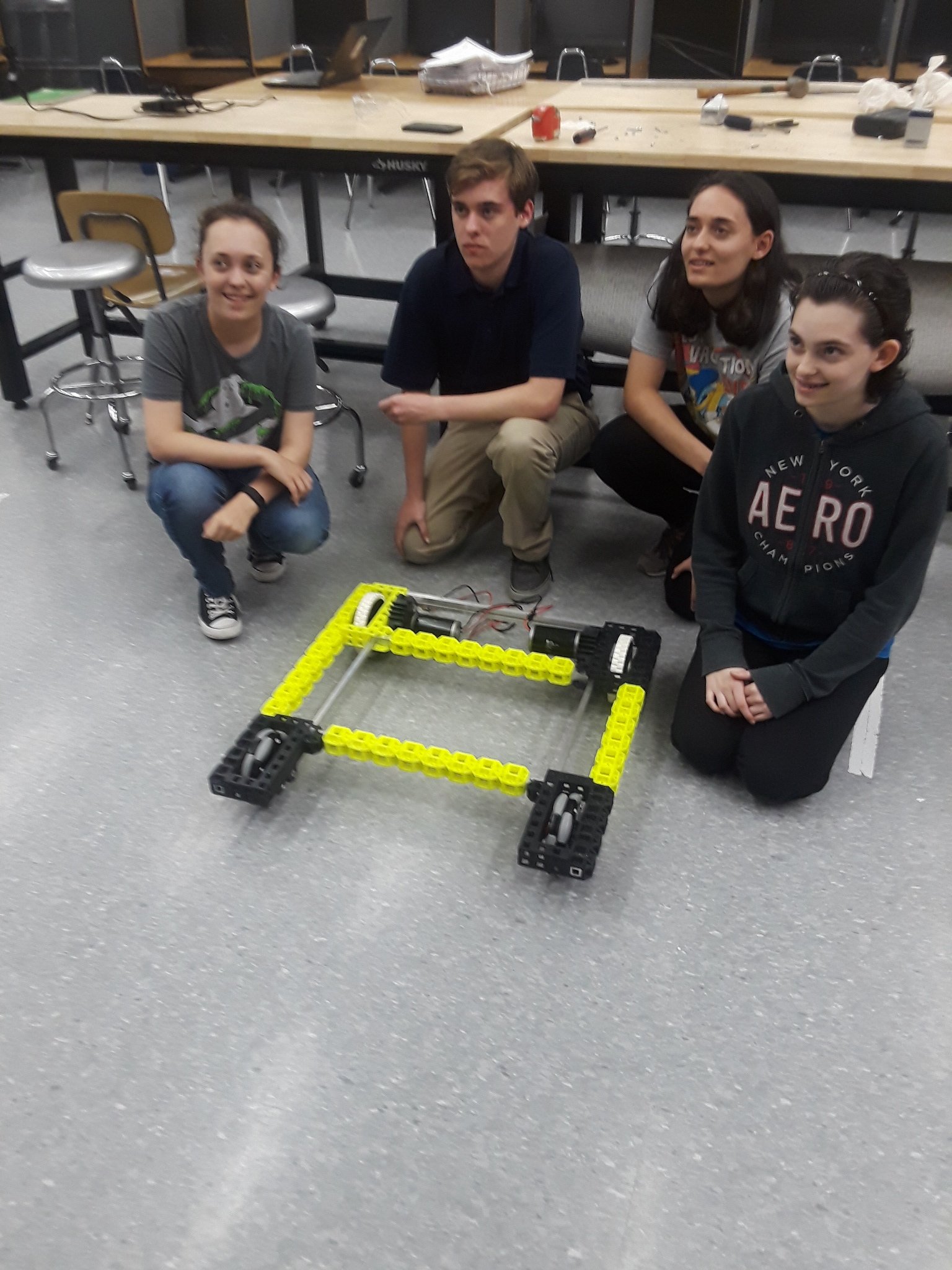

That is in the works The project is further along now but this is a pic from “wheel down” day which for us is when the wheels are mounted and all 4 (or how ever many) actually touch the ground at the same time

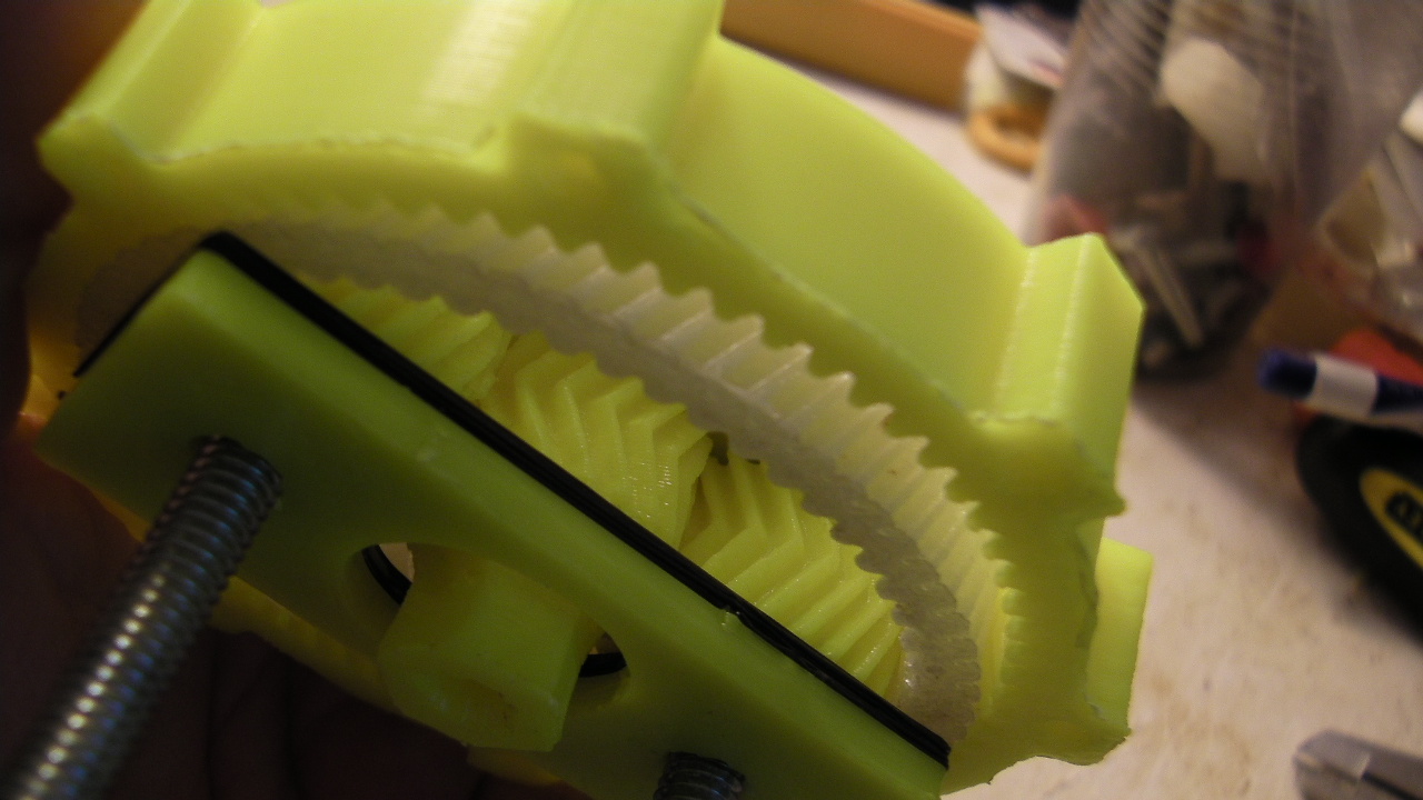

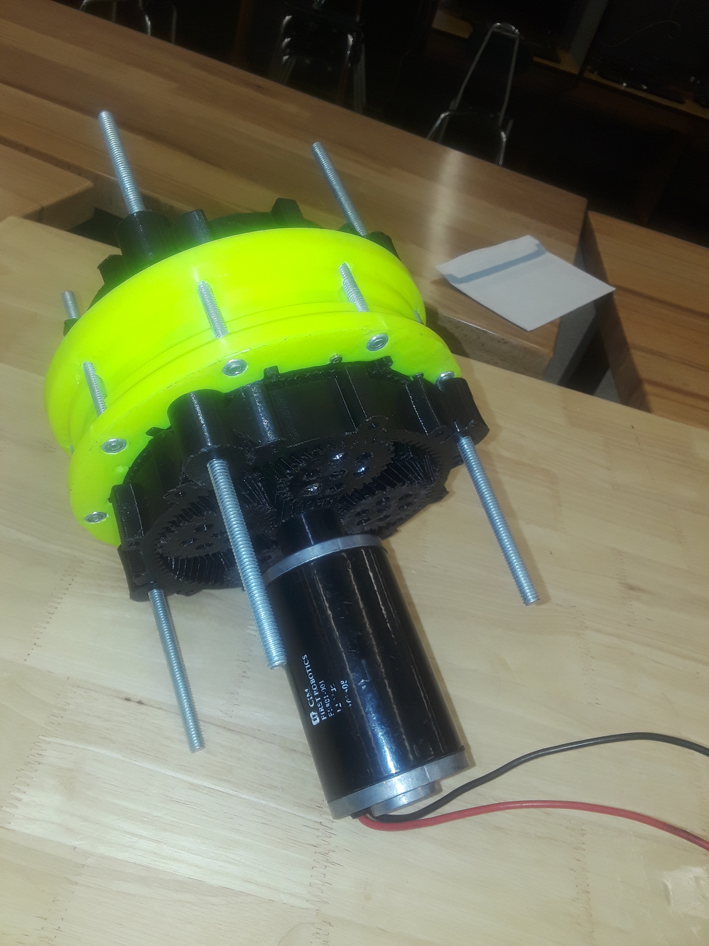

And that is the 400:1 coming along its a pain to assemble and align and we learned a lot from that

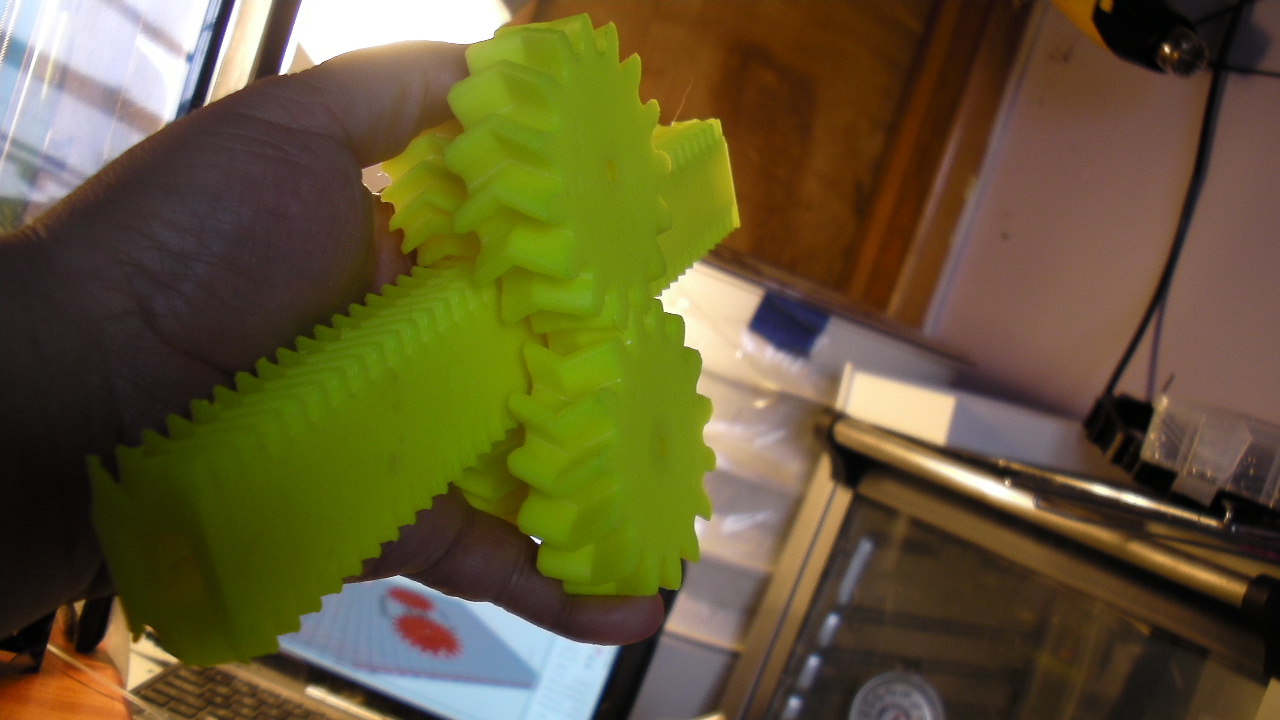

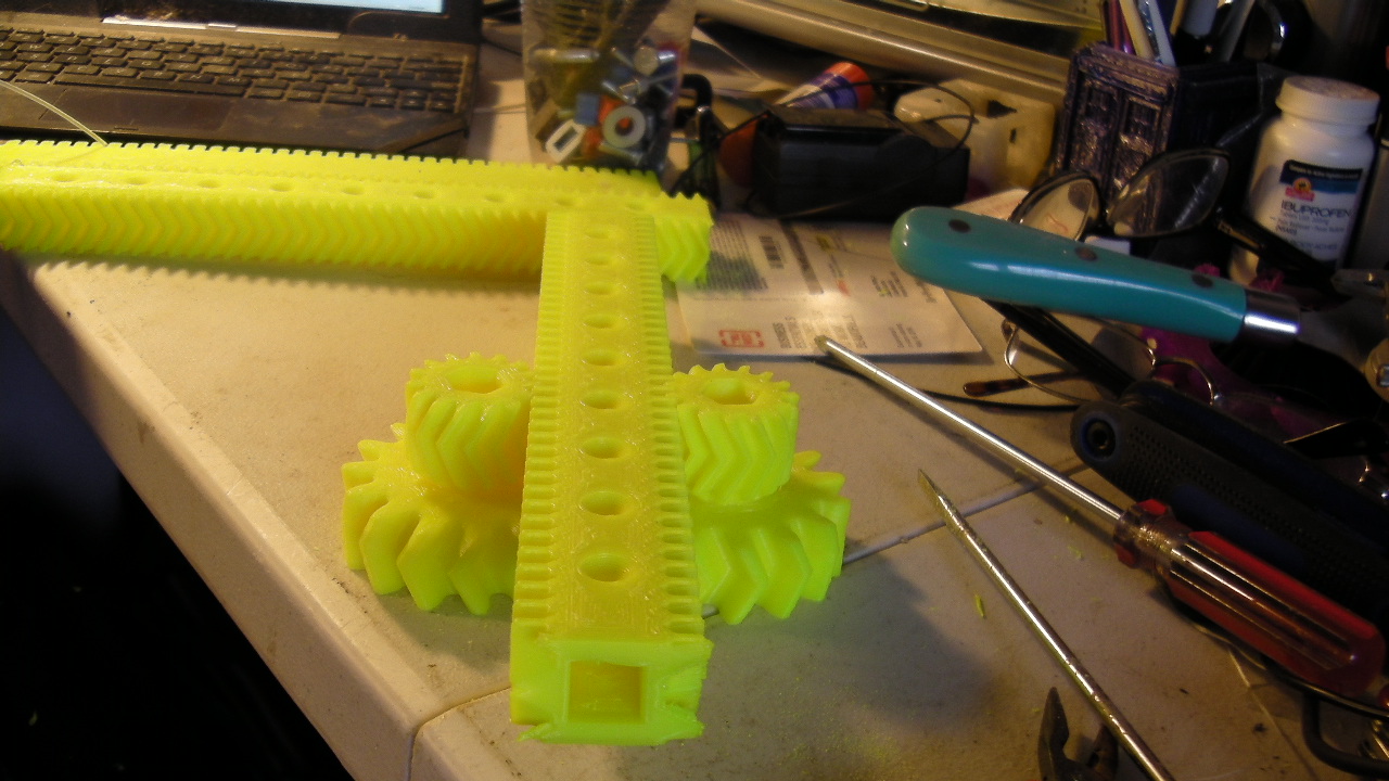

No I don’t only thin “unconventional” we did so far is that we 3d print them and all of our gears are double helical involute gears and we used double rack and pinion gears here are parts of our updated version

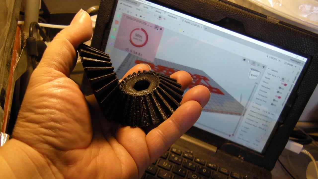

And we also print bevel gears

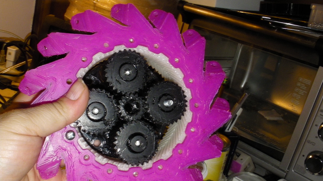

Amd working on sticking a planetary into a wheel
With a mechanum mount slipped on as “tire” Actually tomorrow I am meeting the lead engineer (a soon to be sophomore) on that to see what progress she and her team made (There are some sizing and ration problems and printing problems to be worked out)
