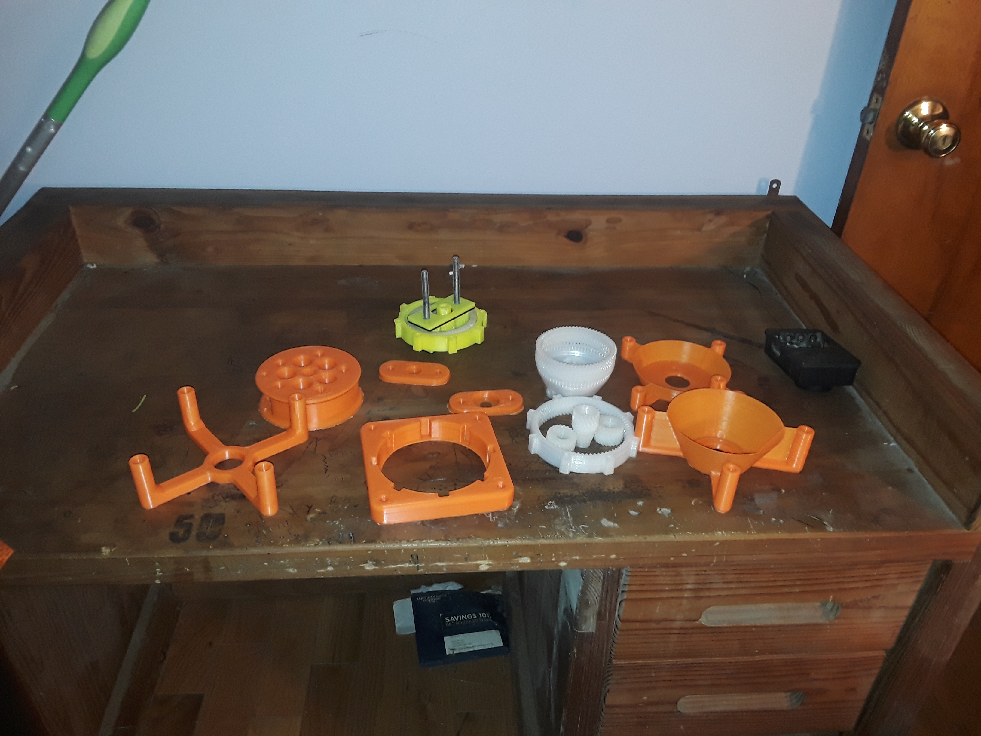

Parts of the gearbox

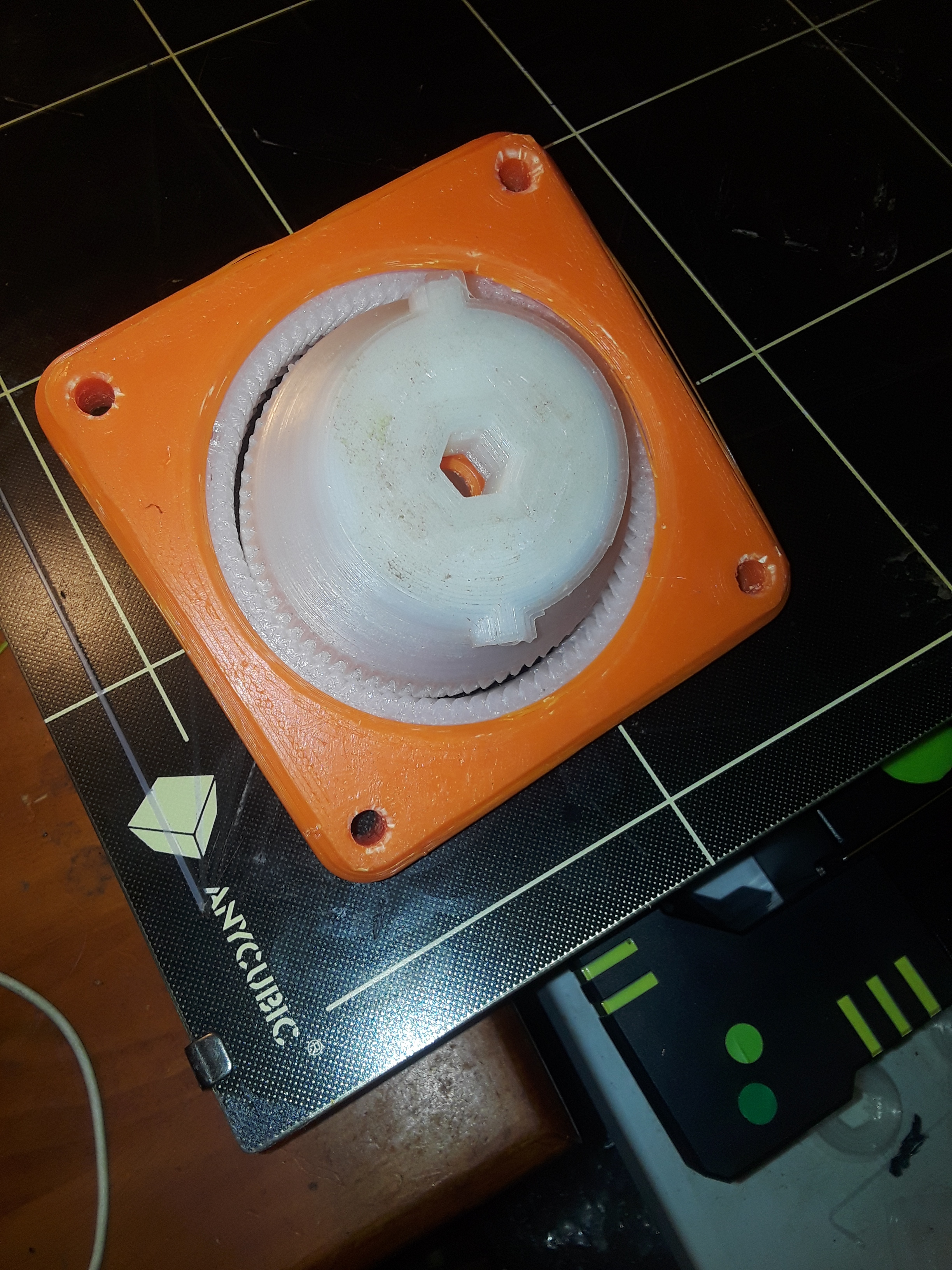

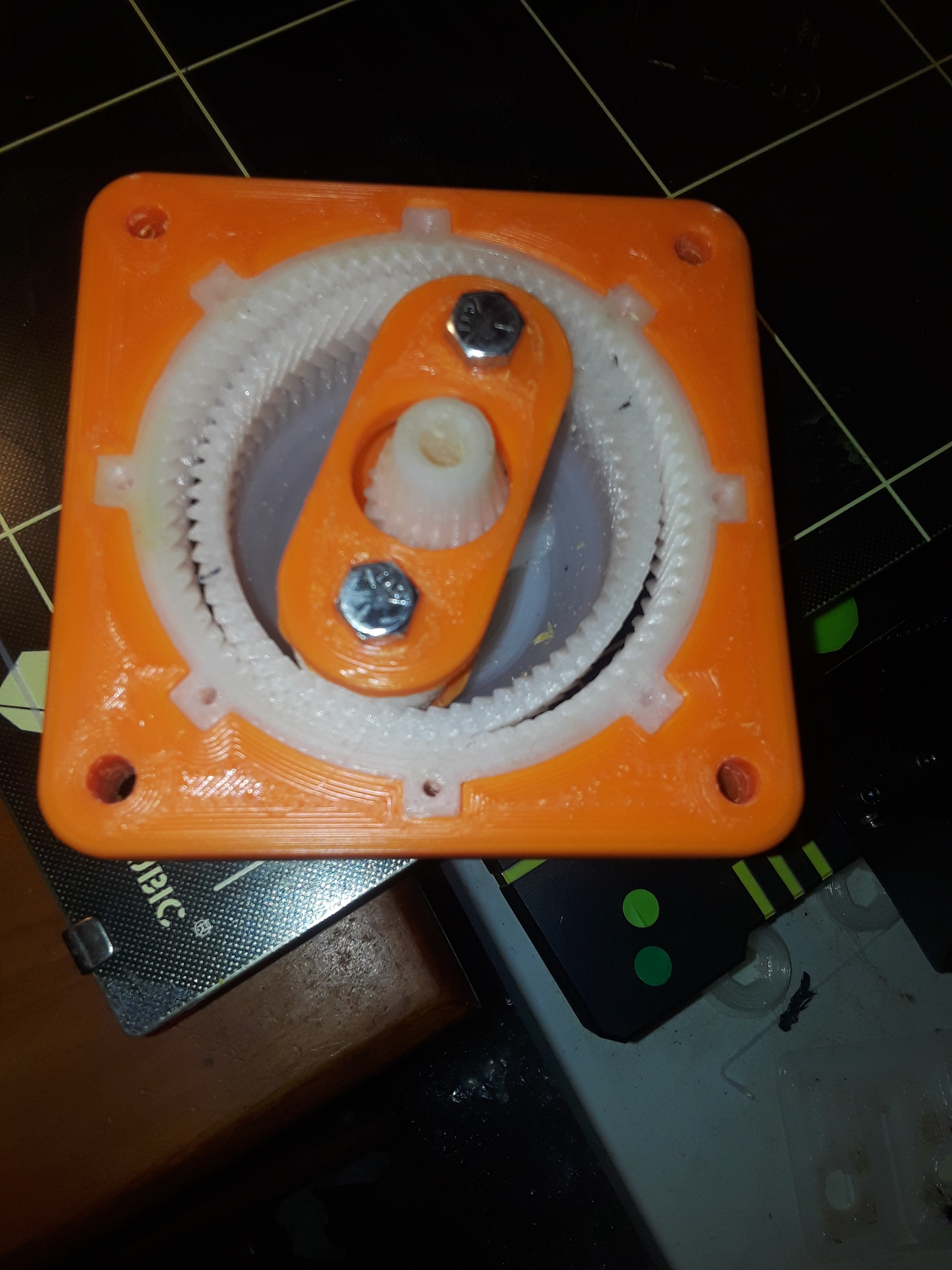

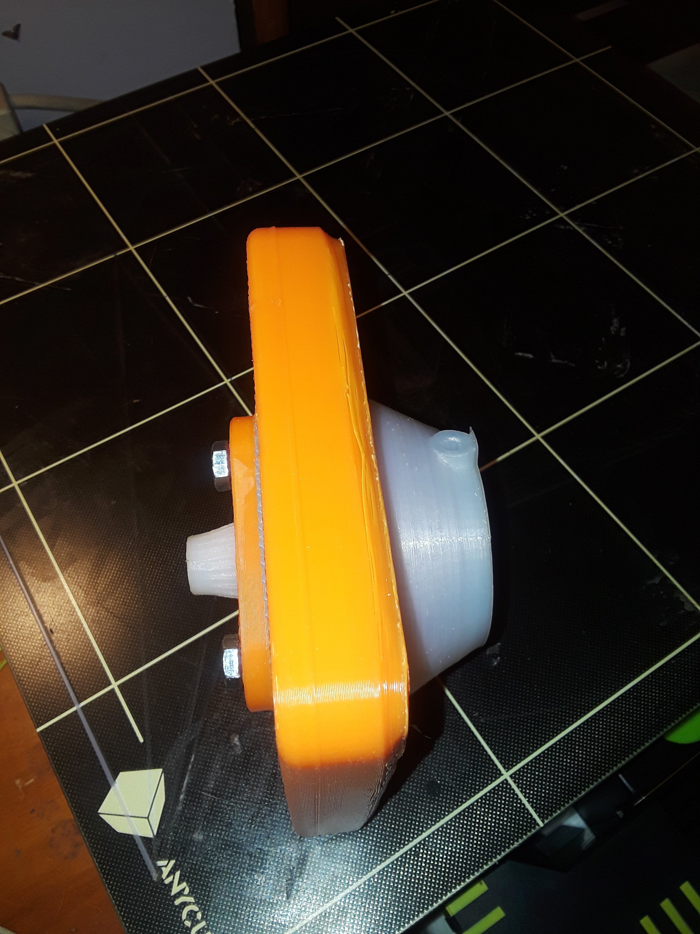

3 Shots of it assembled without motor and cover to show the guts
About 70:1 reduction. Has been successfully “dry run” without a load. The intent is to see if in this configuration it can lift 1 or 2 robots. My thought is at this time I probably should increase the size a little by upping the modulus to 1.5 and make the planets a little bigger to closer approach the elliptical bearing at the end and have more teeth engaged
