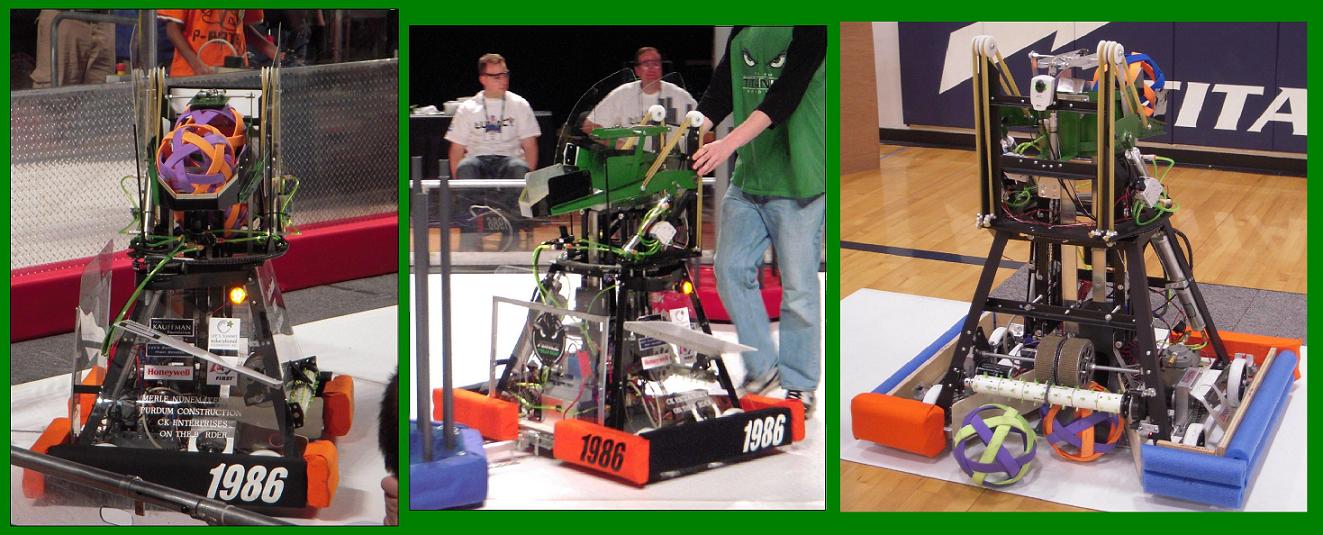

I know you are refering to trailer scoring rather than empty cell delivery, but for long range shooting there are surely not many bots as crazy as 1986. I refer you to this post:
The empty cell delivery really gives the alliance a big strategic head start. I will not claim we have scored a lot of long range trailer shots, but occasionally we hit a long one. We can spit them in at close range like most.
