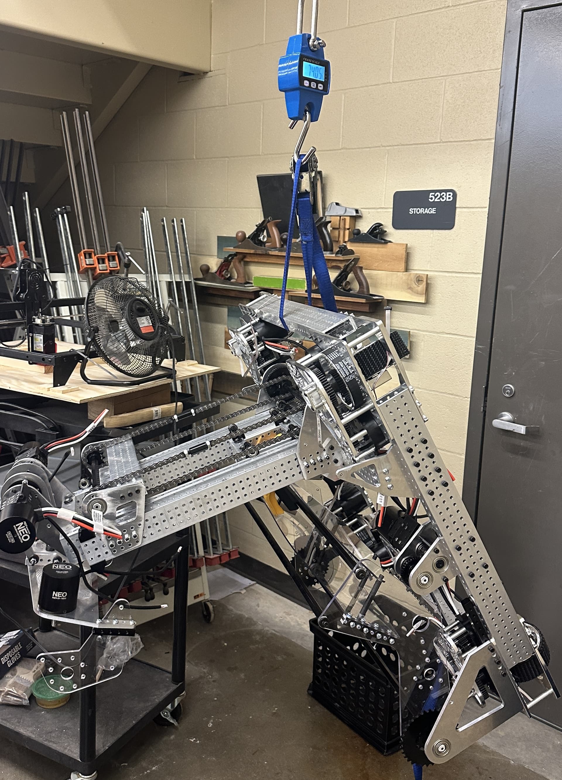

We debated it at first but then realized it’s just so difficult we’d spend 3 days doing that and not much of anything else. I fully believe it’s needed to control your own destiny throughout quals and into elim rankings, but it feels like it needs its own entire mechanism.

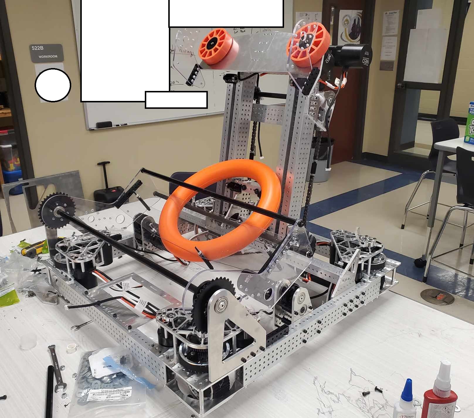

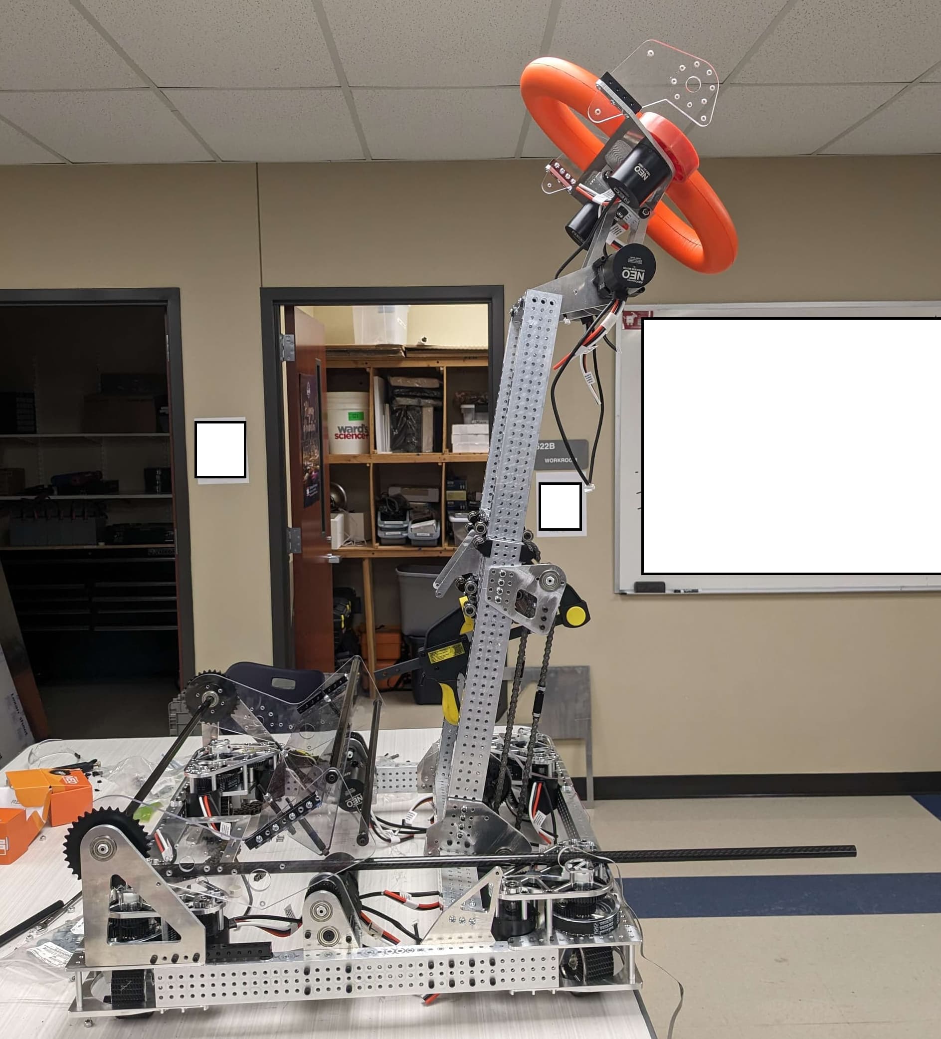

We dry tested it and it’s looking promising.
*edit
There was some student info and our team QR code in the background. Woops.

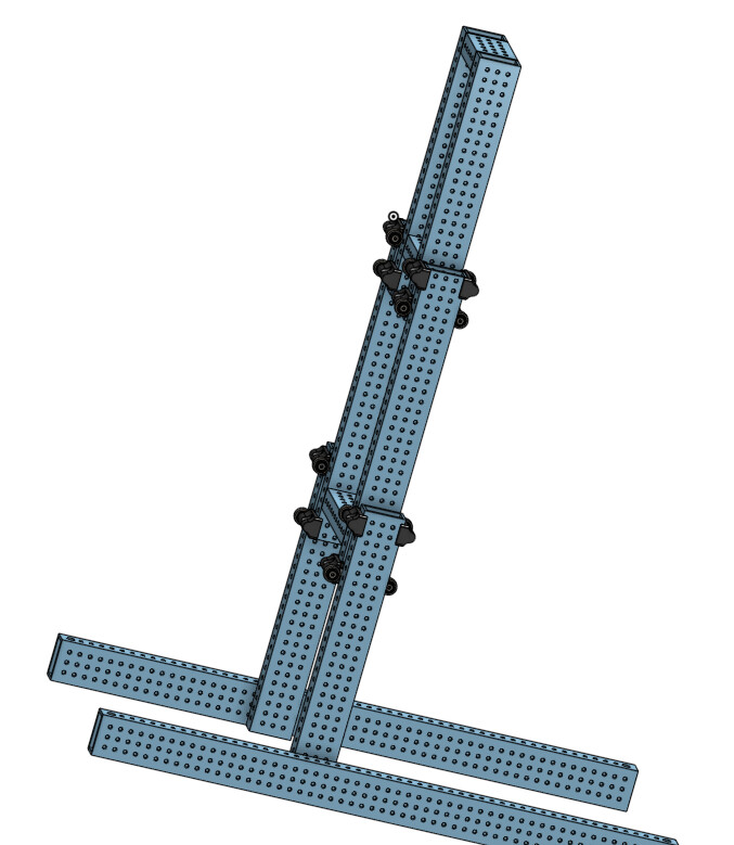

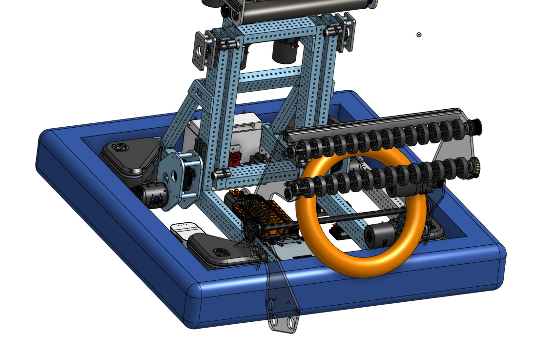

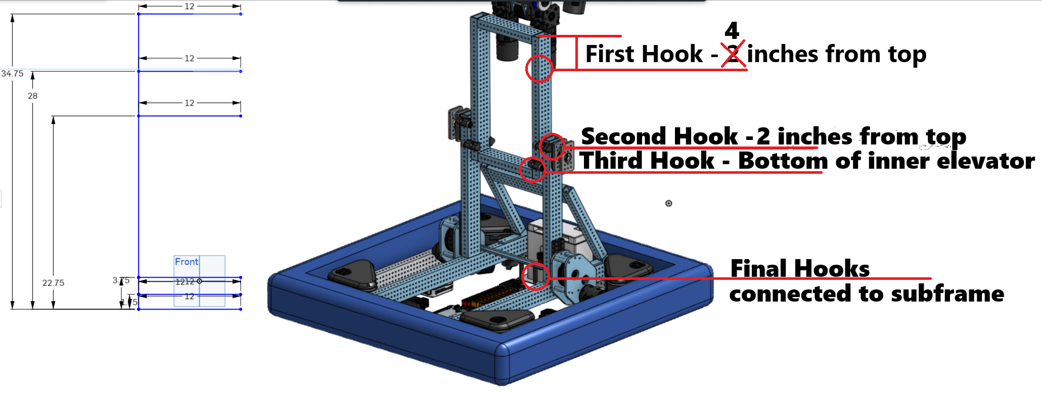

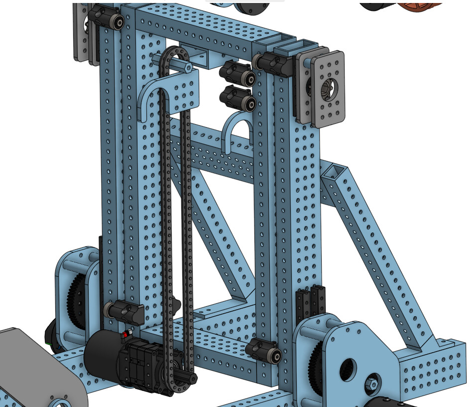

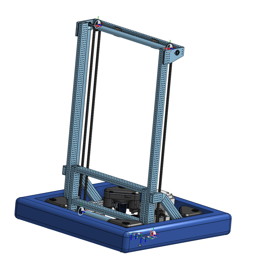

However the first iteration of our design was freakishly similar to yours (without seeing it).
(this was the very first thing on paper)
(Decided to put shooter on the top of the elevator)
(Struggling with trap scoring and pulling down the chain)
(this was called the “garage door”)
(This was us realizing we needed to tilt the elevator and climb on the inner carriage)
Then this was today after seeing the geometry of @howlongismyname
We very much yoinked the hooks and climbing forks.
We were able to get so close so fast because the original design was very close to one another.

We made a mechanism that works with picking a note up and scoring it. We just need to decide if we are going to peruse still doing the trap and also mount it onto an arm. Luckily though we have seen a lot of CADs and driving sketches of arms we could use which might help with the decision making.

Convergent designs happen a lot, it’s not really a surprise that you landed on the same design architecture. Glad there is discussion on the topic in the thread about the details, in effect a community design review.
What is surprising to me is how the thread was missed by the team considering how popular it was over the first few days.
All that being said, the design was open source, so it really doesn’t matter if some inspiration did diffuse from that thread into the early talks by the team. The devil is in the details on execution, and building something is a whole 'nother kettle of fish.
