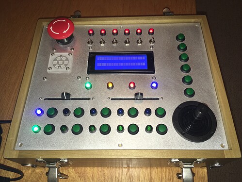

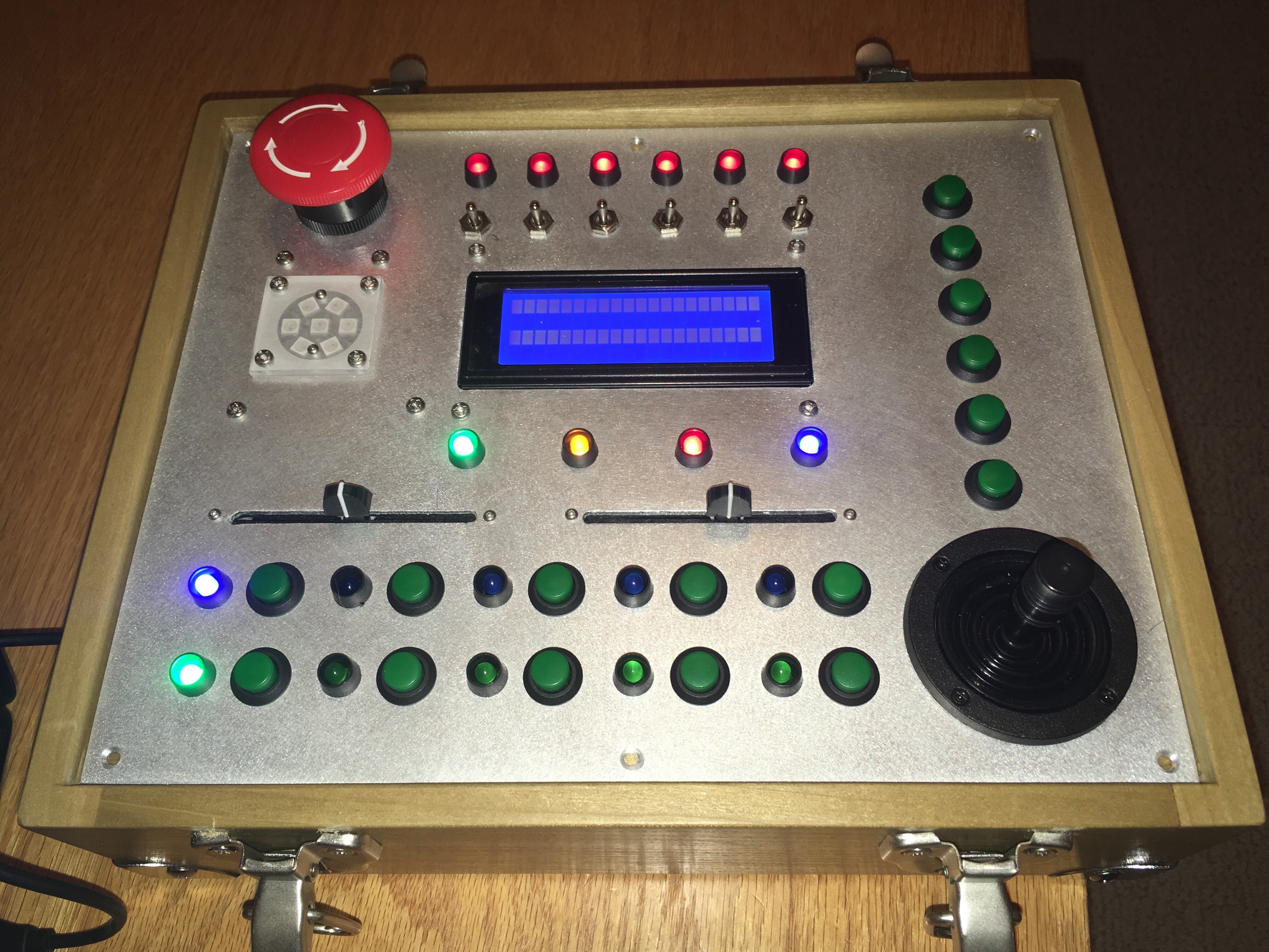

When 6328 experimented with a “full-up” operator panel a couple of years ago, we included a lot of output capability. The controller we built supported a 20x4 character LCD, Neopixel ring, and PWM-controllable LEDs that could indicate multiple states including slow/fast blinking and pulsing as well as simple on/off. The initial panel build looked like this:
Control of the outputs was via a serial-over-USB interface with a simple protocol we invented. The inputs presented as normal joysticks (x2 with a total of 6 analog inputs and up to 24 button/switch inputs) and a keyboard (for e-stop). All outputs were driven with a Python script on the driver station that spoke NetworkTables on the backend and to the USB-serial port using our protocol. The hardware was based on an Arduino “Leonardo” 32u4 board with a custom shield we designed, and using an Adafruit 24-channel PWM LED driver.
Though this was fun to put together, in the end our recent drive teams have preferred XBox controllers so this got set aside. We’ve occasionally considered reviving it for use at demos (kids love this sort of thing - so many buttons and blinkenlights!) but to date haven’t really done so. If we seriously returned to this approach for competition use I think we’d revisit the controller hardware as there are newer boards that are better choices to base it on; we did have some issues with button inputs on this version that we never resolved, which were probably related to the I/O expander chip we had to use to get enough inputs into the Leonardo.
