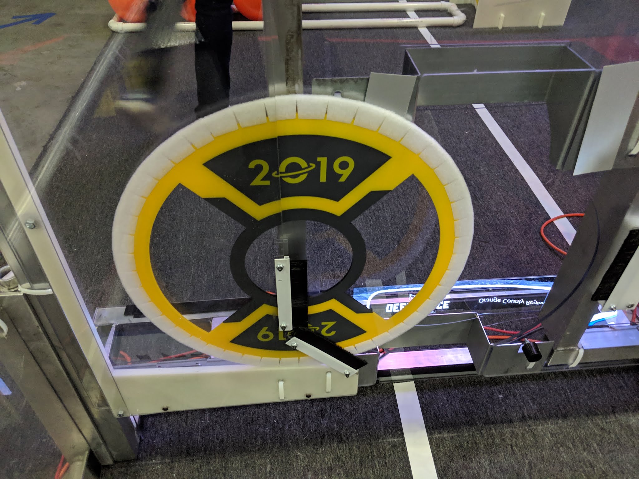

I’ve watched a handful of matches yesterday and today, and it seems that panels are regularly getting stuck in this position. Can anyone at an event confirm? What, if anything, can human players do to dislodge the panels?

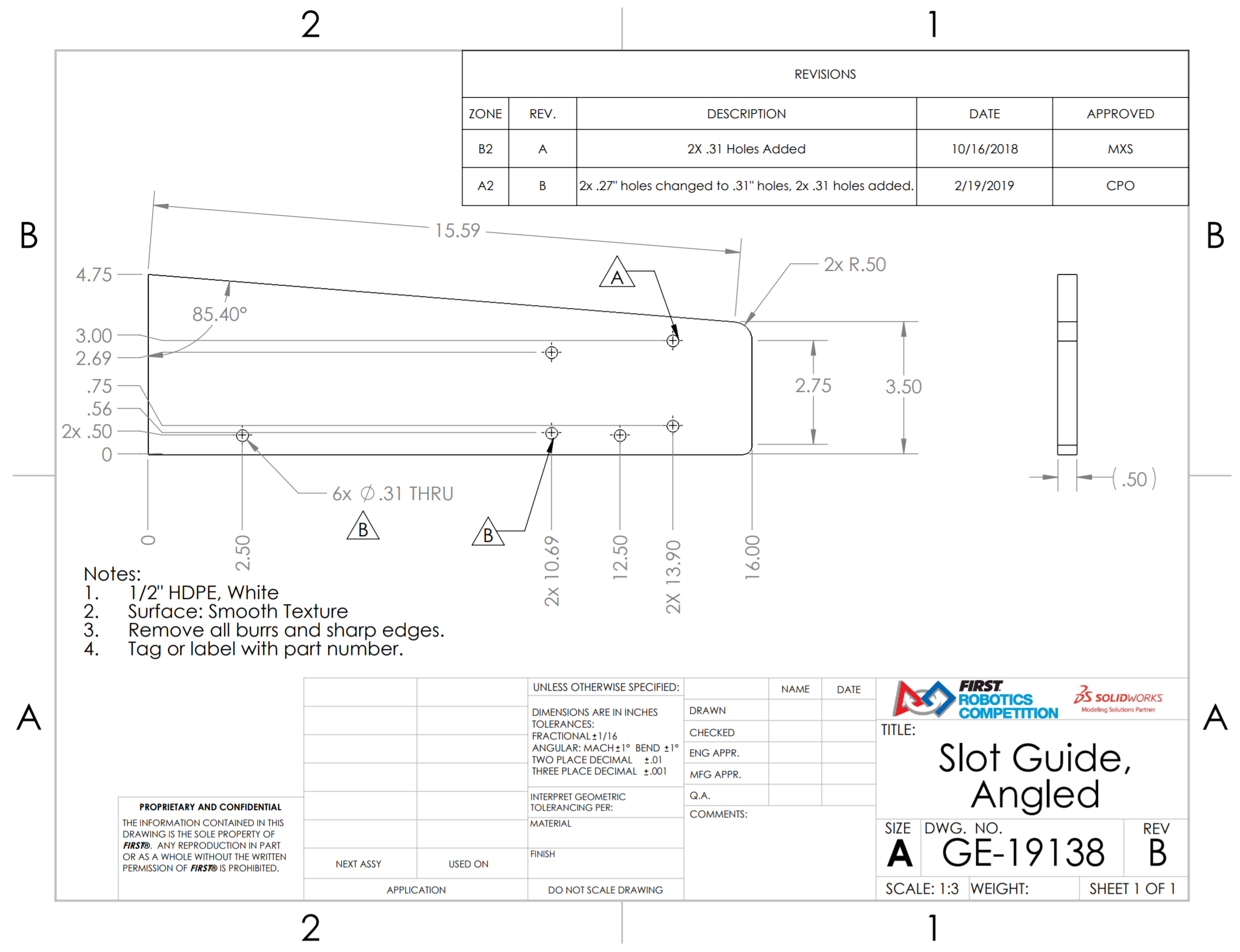

Yes, and FIRST engineering was on-site at Week Zero working on the loading stations and planning how to fix it, which led to the drawing updates in Team Update 13.

Can somebody confirm why this happens? Is it due to a robot hitting it to the side or is it something to do with how the human player drops it?
#9
When we’ve encountered this on our home field it’s usually the result of the brushes getting bent back. Those bristles are pretty stiff.
#10
This was happening very frequently at the official week zero event. Seemed the best way to get around it was to enter the hatch panels as high as possible and let them drop with enough speed. If they don’t have the momentum they will bounce in place at the bottom and get stuck as shown.

This just happened in one of our matches at the Palmetto regional. To fix this we dropped another panel in. This could prove problematic for some teams though as one hatch panel may become stuck behind the other and make the center hole of the hatch inaccessible for some teams.

#20
Is there any reason you couldn’t crank this up to like 20 degrees? That seems like an easy drop-in fix that FIRST could ship out.
