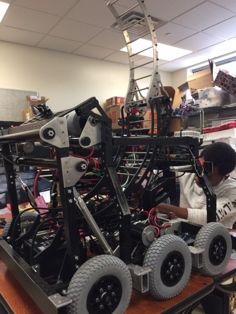

The hatch system is just part of what we do. We want to ensure we can move hatches and cargo to both the ship and rocket quickly, Also, we kept size and weight to reasonable levels and can play defense if needed. I would have rather had the ability to hit the top rocket cargo as well but it just didn’t work out (design experience and time constraints. Here’s a bag night picture. We may not be “purdy” but we’re ready to see if all this works or not. See all at the Greenville, Texas and Dallas Texas district comps soon!
