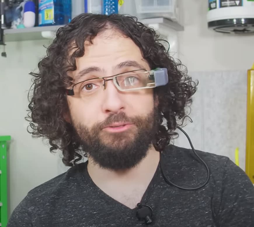

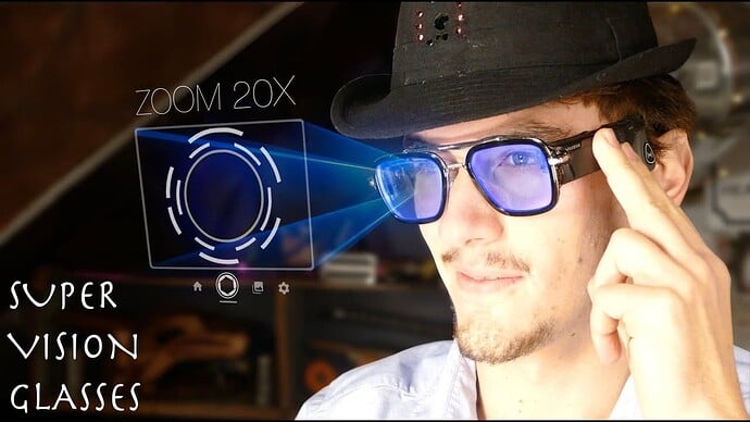

I’ve been thinking about various ways that information could be better displayed to drivers. I’ve seen some teams with displays mounted arms but I think glasses might be easier to read. So would it be possible/legal to use glasses with displays in them? What other high tech gadgets can you think that can help?
Some possible examples:
Something also similar
You have to plug them in after auto ends which is very inconvenient. Legal yes, but having to waste time after auto ends loses any advantage they would grant.

A similar COTS item to Zack’s monocle that I think could be made to follow all rules is the Vufine VUF-110 Wearable Display
https://www.amazon.com/dp/B01MZ89QXF
You might be on to something with that. HDMI input only, magnetic attachment to glasses.
