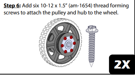

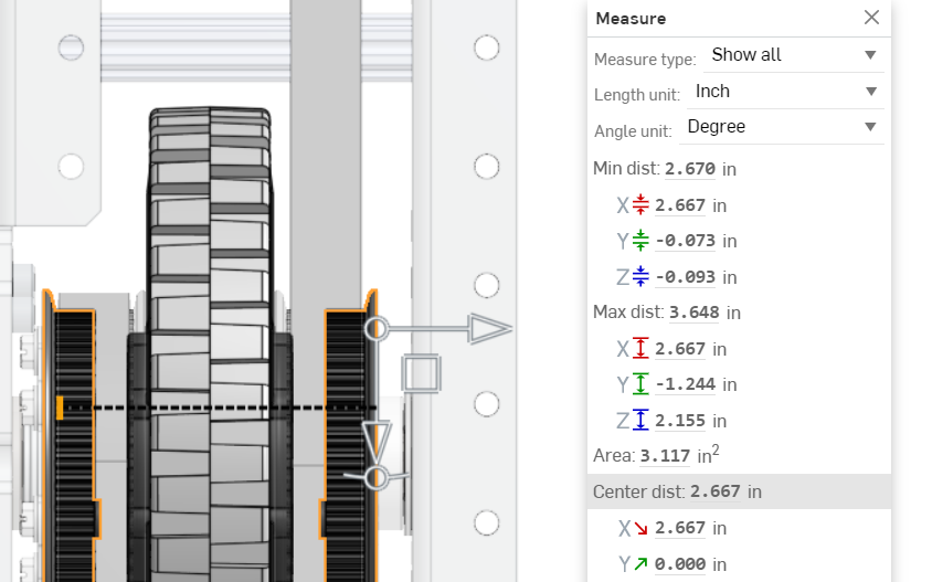

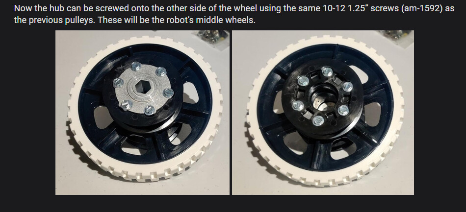

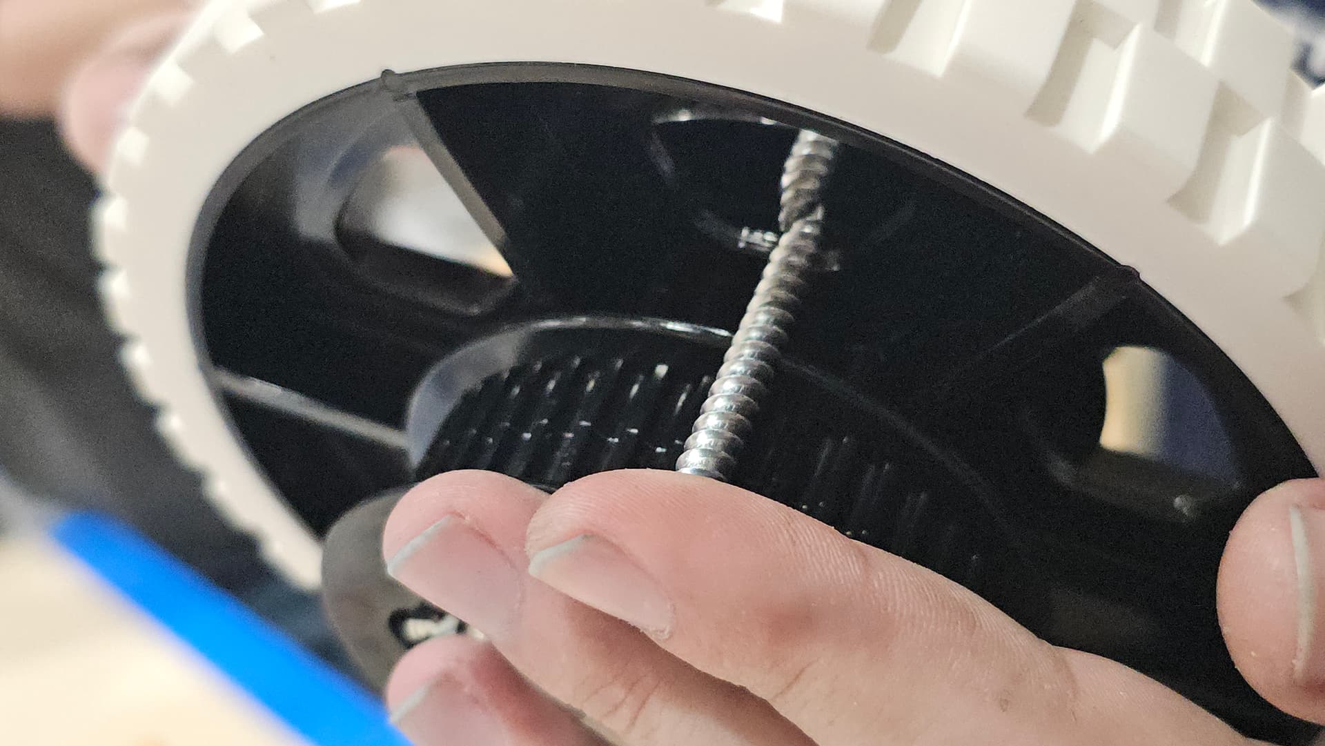

Hello everyone, member of the Everybot team here. We found the following issue when assembling the chassis wheels.
The 2024 AM14U5 chassis comes with 10-12 X 1.5" thread forming screws vs the 2023 10-12 X 1.25" ones.
2023
2024
When assembling the center wheel there will not be enough room to have 6 bolts on both sides.
Currently we are going to try alternating 3 bolts per side but will wait for guidance from Andymark.
