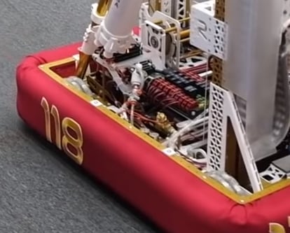

I had to go look at it myself after reading it. Here’s a capture from the video, when they have their bumpers off:

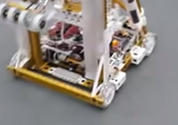

Based on that image, I believe they have a full frame perimeter identified, with appropriate backing for the bumper. A shot from a different portion of the video shows nothing that I would call a removable support on the open side where their wheels are - in fact, I believe the white tabs are part of their mounting system, which would place them right at the point where their supports are.
The cold anodized “frame” that goes along the top of the bumper is clamping the fabric to the wood, not creating a frame perimeter or interface.
118’s reveal video?
there are moments where they drive bumperless and i realized my ignorance of the bumper ruleset for the last 4 or 5 years. i always assumed there had to be a continuous backing that defined the frame perimeter, in order to do so you need a rail over the wheels (see 254 drivebase). you can also make out how they use a bracket that remains on the bumper and frame.
maybe im wrong that its counted in with robot inspection. but i’m really just admitting to my ignorance of the latest bumper rules.
@Tyson - if you look at the first screen capture I posted, you can see white frame pieces that stick out between the wheels. Those standoffs provide the bumper backing required by the rules. I assume they are set up so the space between them is <=8", and the space between them and the front/back rails is <=8". Those white pieces, along with the front/back rails, constitute the frame perimeter. Any other parts you noticed on the bumpers are considered part of the bumpers, and are weighed with the bumpers.
Yeah, I agree. What 118 actually did is not really my point.
I think you could design a detachable frame and bumper support brackets as part of the actual robot frame perimeter, with the intention during an event it mostly stays with the bumper.
How metal bumper frames and supports get inspected is potentially a grey area but really, I’m not a rules nerd and dont care to discuss it or argue any side. and dont mean to point out 118, just recalling the moment I realized the frame perimeter rules have changed since I started, and quite a few years ago without me realizing it.
