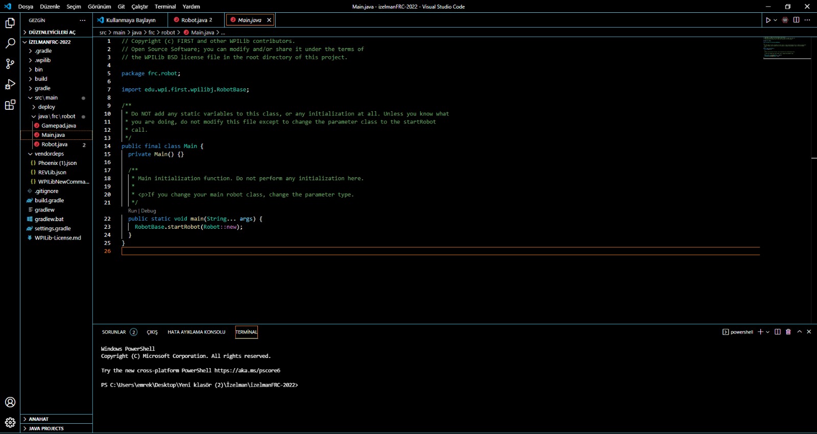

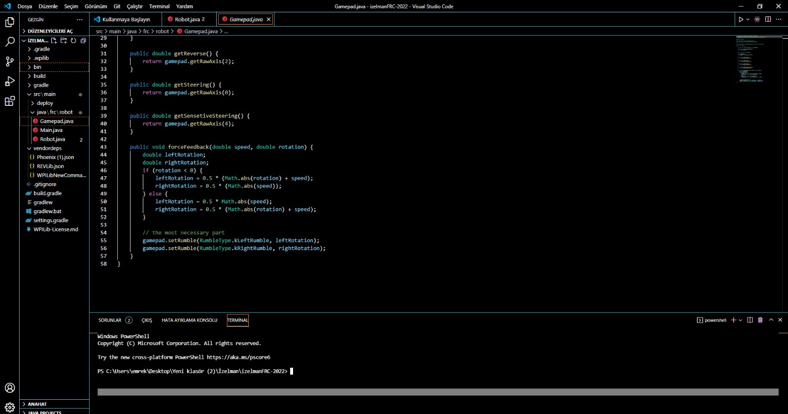

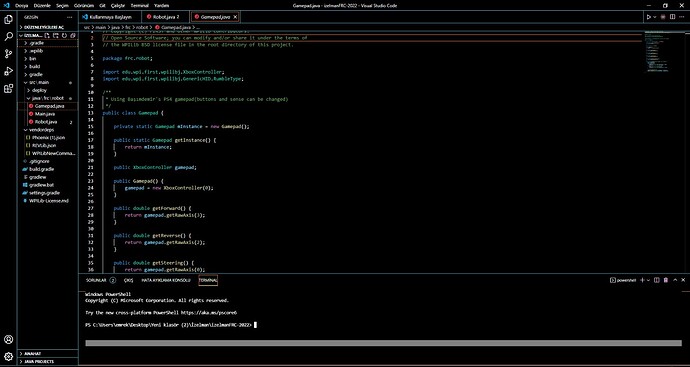

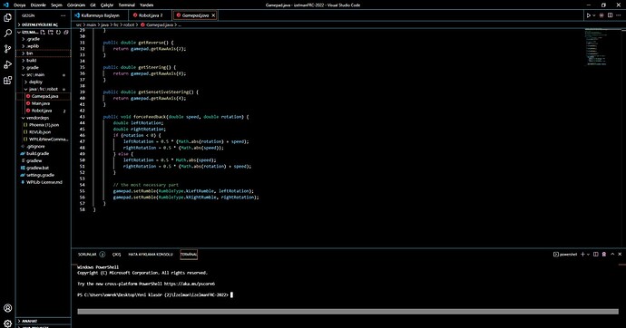

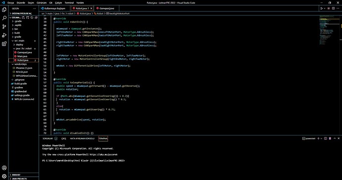

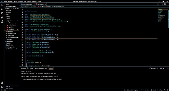

Hello i started FRC this year.Can you guys help me for the code?(site didnt allow me to upload more than 1 photo , so i reply the other photos)
