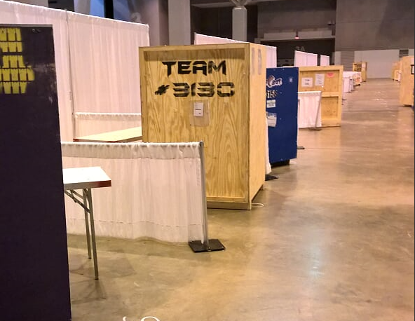

FWIW, here’s a view of the pit shortly before the mayhem/load-in begins. Note that you’ll get a table in your pit.

We are going to be another Champs Rookie and I am wondering what are the pit dimensions. They look smaller in the picture than regional pit sizes. We have always been really bare bones in our pit but having a banner now makes us want to build/buy something that will we can use for Champs as well as future events. So maybe we need something adjustable. Any suggestions along those lines as well? We don’t want the tent set-up (roof makes me claustrophobic).
As a district team, the CMP pits at St. Louis seem to be the biggest we get all season. The pit is at least 10 feet wide (it’s the only pit our banner actually fits in), and I think the depth is a bit deceiving in that picture.
Every year I have been to Champs pits have been atleast 10x10 if not slightly bigger
